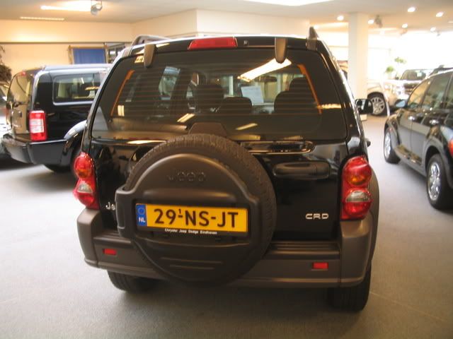

Talking with RedKJ666 the other day got me thing of the difference between the North American Liberty's tails lights and the European Cherokee (Liberty) tail lights.
The tail lights look identical however on the European model there's supposed to be a rear foglight (???). Just what is that supposed to be and how does it operate?

the lights on the bumper turn on for fog lights. my rover used to have them.

ahh liberty fever i never answered your question the Euro liberties have a rear fog light... it turns on with the other fog light ( its wired into the coputer differently). it is a mandatory spec in europe. basically its just another bulb down there and the reflector is different then a regular brake light. then put everything else that was said after this... ti should all make sense :-)r

Euro is not hte correct term, it is a marketing term
E-Spec is the correct designation for all european spec cars and trucks.
Rear fogs on a KK are in the tail lights only
Both sides light up
This is the half round section of the lower part of the light.
There is a different switch for using the rear fog light on the headlight stalk, all Chrysler products have this.
Front fog lights are an option, rears are stardard by law.
The front and rears are independently, first comes the front then come the rear.
The switch works and looks just like yours except: You have to pull the end out like normal but it has a 2 position switch in it.
There are no lights in the bumper, they are only reflectors.
There are changes as well with the headlights and antenne for the e-spec KJ and KK.
