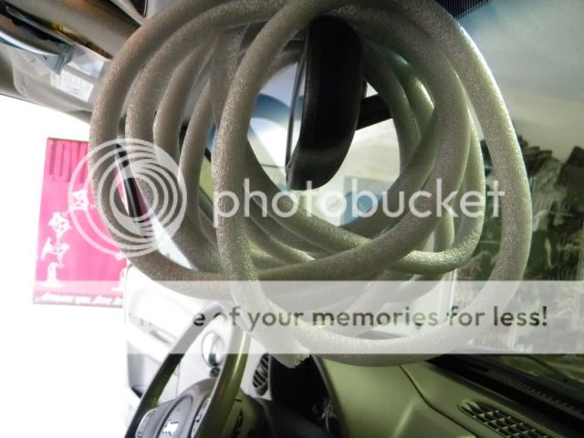

foam (see below)
$3.50 at Home Depot, in the weather striping section, or you can by this stuff, what I used, $35+ shipping here, as it's Nasa Certified, astronautical, vibration dampening matter. It's just like the $3.50 Home Depot stuff, but guaranteed to add 10 HP. :happy175:

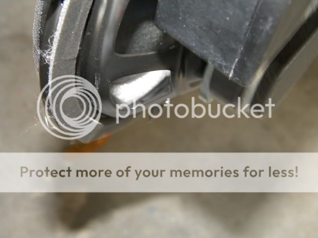

And then you get to this part:
Take one strand of it, rip it off. Don't try to fit a lot in. Only put it on the outside of the cone. Tried inside, didn't work as well and it deadened the sound bad.
