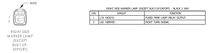

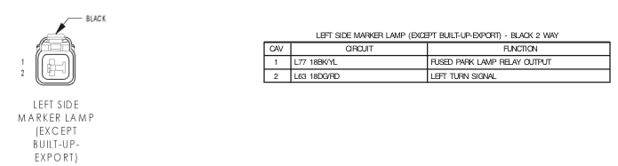

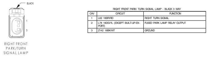

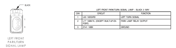

Hey Infernicus, would you be able to tell me which wires do what for the front turn signal and side marker? Trying to get some LED switchbacks in there.

Oznium is a great site, I've purchased many a LED from them.
Sorry for the thread jack Surf.. Hopefully this helps..
