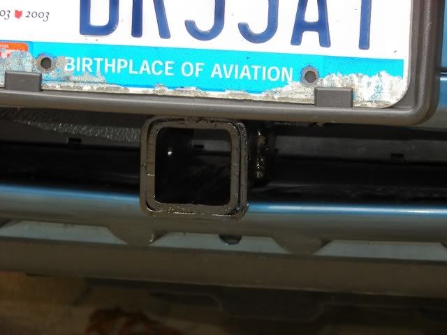

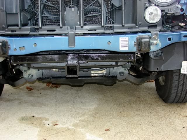

I can't tell a lot by your pictures but it appears it comes out lower then the one I made for mine. My reciever comes out just below the main part of the bumper requiring raising the license plate that can be done by turning the bracket over. I didn't have to cut anything but the reviever section is squeezed out in the space just below the license plate.
Draw-tite used to make them but stopped when DC/Jeep changed the bumper. As I recall the 06 Limited front bumper is different still.
Years ago there was a member here who worked in a fab shop that made them for group members who wanted them and it was know then there were install problems with later bumpers.
I forgot to ask, how many bolts per side, 2 or 3? I decided that two per side were enough for my purposes.

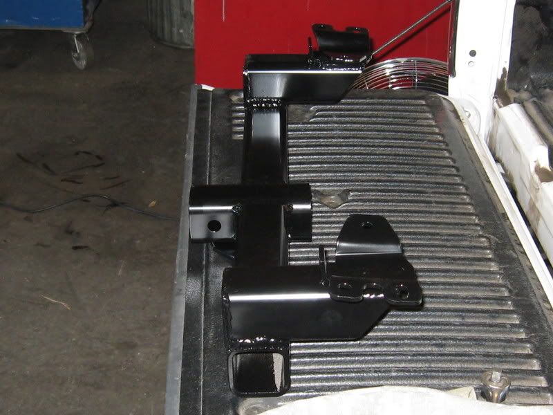

This is one that somebody made, you can kind of see how its made.
It's very sturdy. I use it to stand on to get to the back of the engine.
Next summer I'm adding a fishing rod holder.
-dbk

Exactly what I am doing but with a fishing cart form Platnium in Coco Florida.

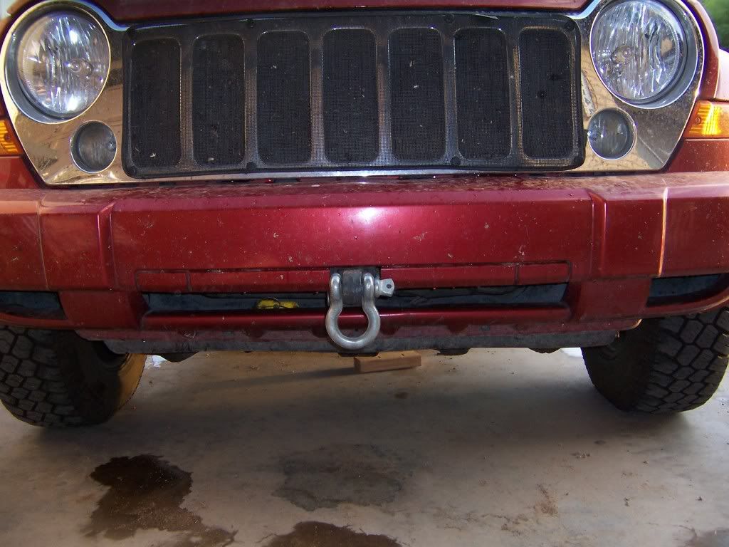

Jins, take it off again, and have someone cut the ears shorter.
This looks sooo weird.

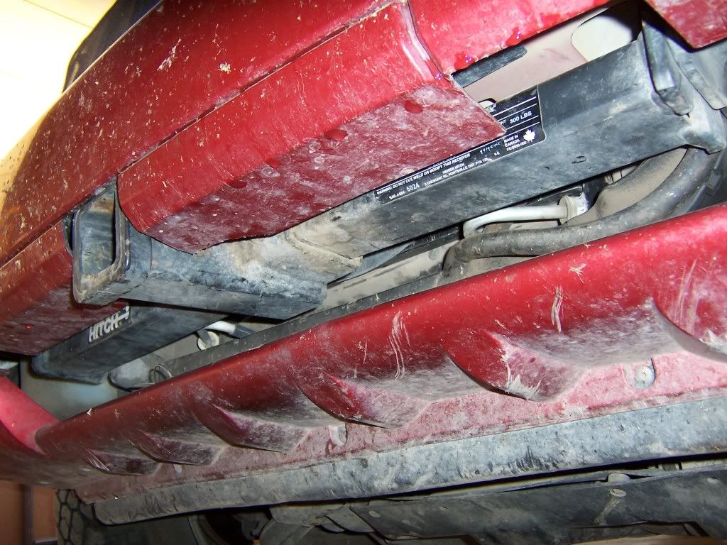

This is where mine sits

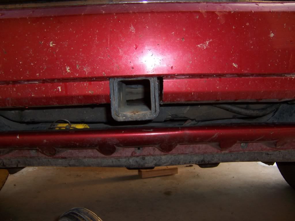

My 06 Limited ended up real clean (looks like the Blue limited) and this particular hitch has total of six attachment points. I will get a pic.

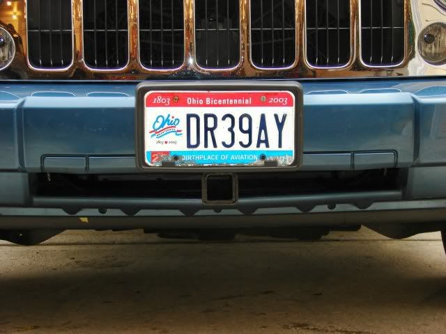

Here's the one I made. The license plate mounted on the reciever may be next :lol:
Notice it just fit in without cutting but I did have to turn over the front plate mount and raise it :oops:
A long time ago someone here posted dimentions and hole locations that I used :mrgreen:

yeah Joe, that's where a front hitch should be, looks excellent. The others are way to low and if you ever go off-road you scrape it on the ground...
And like Fil said, we do not have an electric fan, we have a beefier steel bladed engine mounted fan. And the 2.5 never came with an auto tranny...so we don't need extra fans.

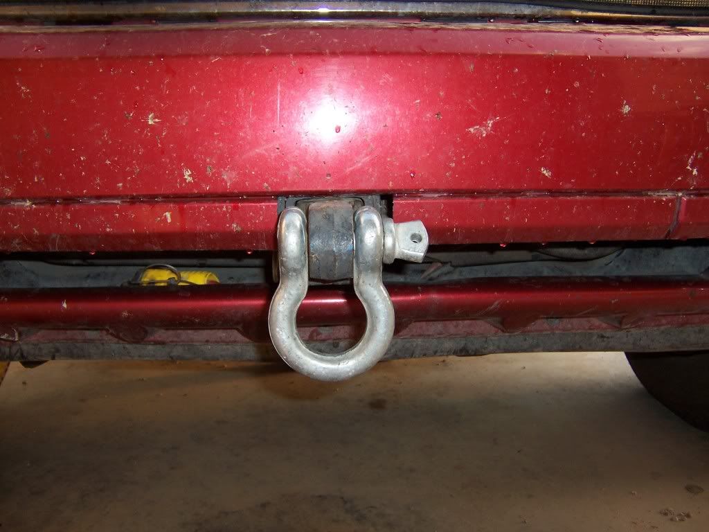

Posts: 553
Location: Tolleson, Arizona
excuse the dirt and bugs....

Silver, that's the same as mine, a Hidden-Hitch.
