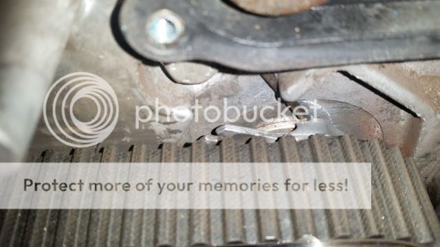

Finally ordered a timing belt pin kit off of ebay, after a few rotations of the crankshaft the intake and exhaust pins go in both cams and i am able to get the the pin through the crankshaft witness hole after bumping the ratchet a hair. What concerns me is on the TB tensioner there is a wierd notch taken out of it by the spring pin. I dont think that extra notch should be there,
When i push on the belt , the tab with the notch on the tensioner rotates CW over an inch. There also seems to be a almost an inch of slop on the lower part of the belt, not tight like in the youtube videos i watched. Should there be this much movement in the tensioner? Or any movement at all?
I Think that i need a new tensioner,any thoughts? I dont think the belt was tensioned properly and i may be one tooth of on the crankshaft, ill try to post a link to a short video that shows how much play is in the belt.
