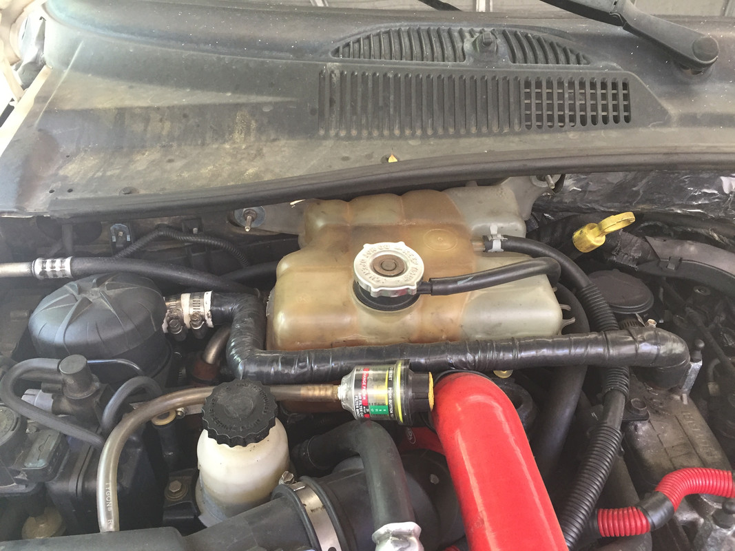

Hi all,
Here is my first take on Provent install on the passenger side. Feeling uneasy with tying Provent filter body to TCM (I got a few gremlins in my electronics already, but that's entirely different story), I conjured my redneck-style holding bracket out of 3/8" OD annealed copper pipe from local Menards. It is easy to bend and when flattened it is wide enough to make a hole for M6 bolt, which is the only size required. One end connects to the long antifreeze expansion tank holding bolt, the other one is held by the power steering reservoir mounting nut (both M6), like so:
Horizontal portion of the bracket is flattened at two points where the holes for filter body clamp are drilled. Here is the filter mounted with two M6 bolts and nuts:
Here is the final assembly:
Additional tidbit: 1" and 3/4" ID reinforced hoses I got from Amazon
https://www.amazon.com/gp/product/89214 ... UTF8&psc=1
https://www.amazon.com/gp/product/89632 ... UTF8&psc=1
turned out to be rather soft. To avoid their collapse at bending points, I turned them into "poor man's vacuum hoses" by inserting a spiral made of steel wire for the full length of the hose. Will see how this holds up with time.

Posts: 7402
Good job mounting!
Friendly advice; keep a close eye on those plastic PVC fittings you used! The vapors coming out of the CCV puck get quite hot.
I had used the same thing in schedule 40, and it started melting a little. Went to metal fittings and copper pipe... :roll:

PostPosted: Tue Jun 27, 2017 11:03 am
Joined: Sun Mar 20, 2016 12:44 pm
Posts: 127
Thanks, will surely keep an eye on melted components! That 90deg plastic elbow next to the puck is a prime candidate.

PostPosted: Mon Jul 03, 2017 12:15 pm
Posts: 127
400 miles down, plastic components do not show any sign of melting, will keep looking though.
