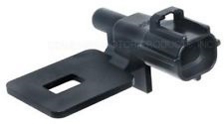

This is what the Ambient Air Sensor looks like:

Yeah I do not have that on my 2002 2.5 Export CRD!
It is shown in the logic diagram but when I look in the Parts Manual....it shows the pictures for all the sensors but that particular sensor is stated to be "Not Fitted on this Model". :shock:
Not a major problem....I have survived for the last 20 years without that sensor!
