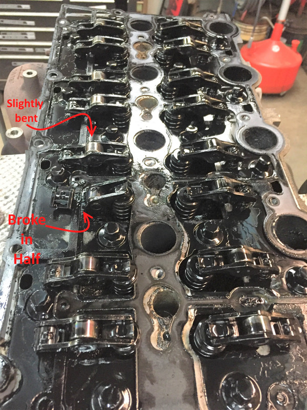

If your timing belt broke and engine spun over, this would allow some of the valves to come in contact with the top of the pistons which by design will break or crack hydraulic dampened rocker arms. This is an "Interference Engine"!
You more than likely got some valves that are not operating on cylinders 3 & 4? :dead:
Time to pull the intake/valve cover and see what damage has occured. :banghead:
FYI:
The engine pictured below is one that had several rockers cracked, some bent, and a few completely broken in half. This was after a timing belt stripped a bunch of teeth and allowed the valves to contact the pistons while driving down the road.
