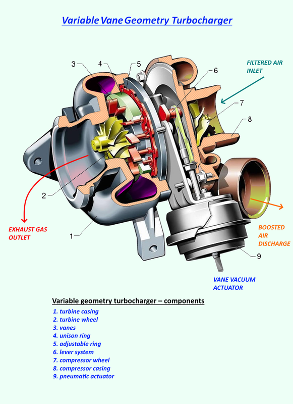

Next possibility; with the engine off, check the stroke of the turbo mechanical vanes by manually operating the actuator with the vacuum line disconnected.
Several owners have reported in the past of finding their variable vanes froze up or partially froze up. If this condition is found, you can try spraying the linkages and vanes from the outside of the turbo with a good penetrating oil like PB Blaster or Kroil and manually stroking the vanes to obtain full travel. But in most cases it does require the removal of the turbocharger and opening it up and physically cleaning the vane operator mechanism. (Item #5 in the picture below)
See this vane cleaning trick that some have used using oven cleaner to keep from having to remove the turbo.
VNT turbo stuck vane cleaning FYI

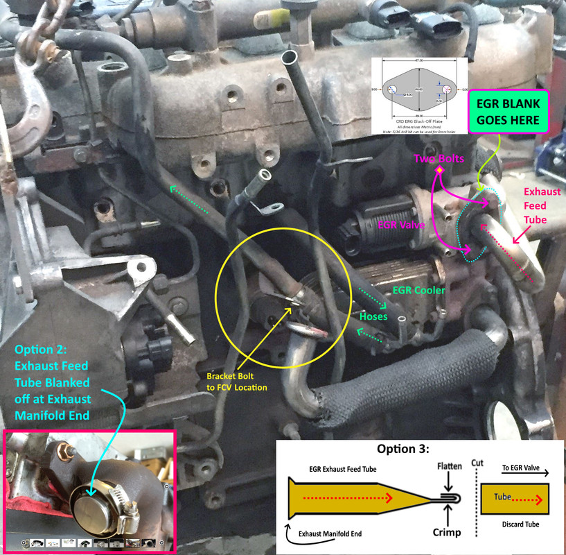

Yes for sure remove the butterfly plate out of the FCV, they are notorious for stripping the little small gears in it's operator and hanging the butterfly partly shut preventing full air flow/boost into the engine especially under higher load conditions.
Next, blank off the EGR exhaust feed pipe at the EGR valve. EGR valves are known for carboning up and hanging partly open thus allowing boost pressure to backfeed and be dumped off the intake manifold backwards into the exhaust manifold. (reverse flow)
You can make the EGR blank out of any thin sheet metal, even a lid from a soup or vegetable can. Tin snips and a 5/16" or 8mm drill bit is all that is needed to make the blank. See enclosed drawing below for blanks dimensions. The blank can be installed in about 15-20 minutes with simple hand tools. see picture below.
EGR BLANKS:

I will try checking over the turbo vane actuator rod and see if I can see anything that doesn't look/feel right. If it seems okay then I'll do the FCV/EGR mod and go from there.

Well, I've removed the FCV butterfly but it was wide open when I did so and the gears were not stripped. It was quite springy and snapped back open with ease any time I rotated it by hand. I was really hoping it would be my issue, but alas. I scraped a lot of gunk out of the FCV pipe but it wasn't nearly enough to be part of my problem.
EGR blanking plate was made from a chopped up beer can. Took me a lot longer than it should've but all the detailed disassembly videos on youtube have been taken down so I was flying a bit blind. I at least knew to remove the fuel filter head. The hose clamp underneath the FCV pipe was annoying.
At some point in the near future I'll buy the kit to completely rip out the EGR system and I've spoken to Yeti about a tune, just have to get her to a basic level of normal function first.
