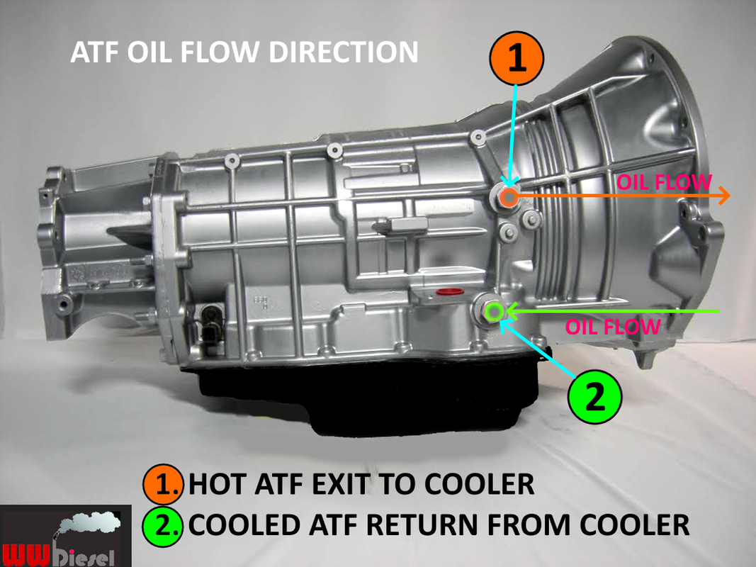

Ok so I am a dummy, I cut off the hoses and did not look to see which goes where.
For the top side transmission line (top side at transmission), does it go to driver or passenger side in the front?
Bottom side go to driver side?
Thank you.
2005 Liberty CRD, 245/75R16, OME CRD Springs front, OME HD rear
 Post subject: Re: Transmission cooling line
PostPosted: Thu Mar 30, 2023 11:44 pm
Posts: 7387
Maybe these will help?
According to the Parts Diagram:

Thank you. You are a lifesaver,.
