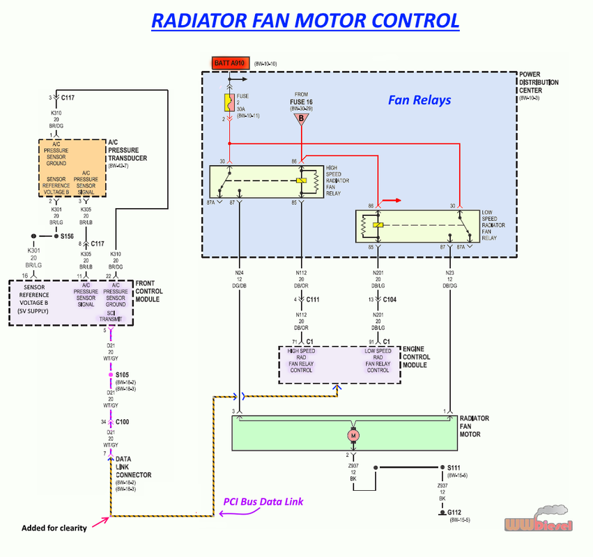

This system has never made a lot of sense to me. If you pull either one of the relays, high or low speed, the ECM will energize the single relay still in place and the fan will run. Not sure why this is as the wiring diagrams does not provide any answers.
Just a wild guess!
Without testing on my own, it may require both relays energized at the same time to get high speed and either one of the relays singularity to get low speed? :?
Just a wild guess!
Interesting...if the fan is rated for 24v and if the relays to the fan are wired in SERIES, but then again how would that make sense since the Jeep has only ONE 12v battery powering BOTH relays.
Or perhaps the fan motor has TWO windings and each relay energizes one of them. I think that this is more likely!
I will disconnect the fan and try energizing the relays individually and combined while checking the voltage at the fan connector...
Still, this is a little hard for me to wrap my brain around,,,MAYBE that is why there is a 3 pin connector for this fan?
I know you said that the fan wiring diagram doesn't show anything decisively, but do you have a link to the wiring diagram??
TIA

 Post subject: Re: Electric Cooling Fan HI/LO RPM
PostPosted: Sat Mar 30, 2024 10:34 am
Posts: 7380
Jeep online manuals:> https://www.colorado4wheel.com/manuals/Jeep/KJ/
See 2005JeepKJServiceManual.pdf, section 8W for wiring diagrams.
This is my custom drawn cooling fan wiring diagram showing all components.
Just a wild guess!
Winner, winner, chicken dinner !!!
After staring at your excellent fan wiring diagram, I decided that eihter the relays are wired in series OR that the fan motor has TWO sets of windings , one relay powering each winding.
NOT sure which it is yet, and leaning towards the latter, but by energizing BOTH relays at the same time, (NOTHING blew up ...another WIN!!!) the fan started spinning at 2400 RPM instead of just 2000.
