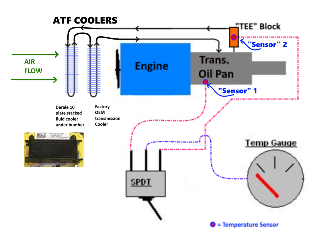

Yes, there is about a 15-20 degree difference between the hot fluid leaving the transmission going to the cooler versus the temperature of the fluid in the pan.
I have an inline sensor on a "Tee" block on the hot fluid line going to the coolers and a sensor in the side of the PML oil pan.
I wired them to a switch (DTDP) so I could switch from one sensor to the other on the fly using only one gauge (Glowshift).
And I routinely see the 15-20 degree temperature difference between the two sensors when at normal operating temperatures.
The pan is always cooler!

Another great idea. My remote Derale 13740 has the dual fan temp sensor switch which Derale says is calibrated for 180 degrees. My fluid pan temp sensor in the bung is a GlowShift. I can install a Tee with another GlowShift sensor and the switch arrangement you provided.
I need confidence that the transmission is not going to overheat now that I have abandoned the factory cooler in the radiator for the remote dual fan Derale.
What should the fluid in the pan be after running for a long period? I have not run for a long period so am curious what yours runs.
Also, do you know what temperature the built-in transmission temperature light in the dashboard comes on?

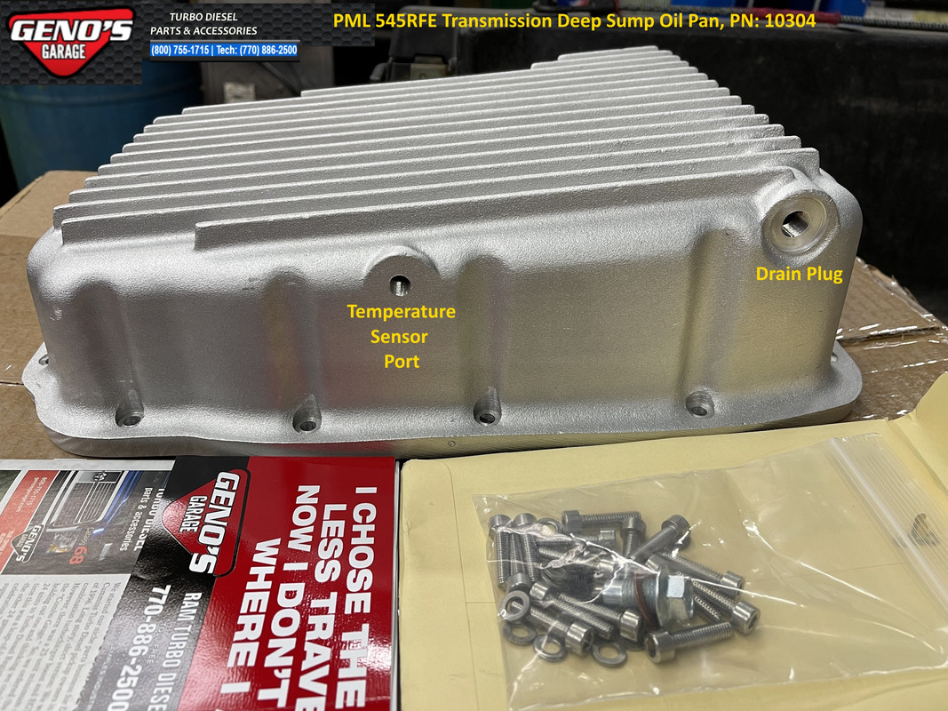

The highest I have seen the temperature in summer while towing in the oil pan is 180-200. Line temperature gets much hotter.
But keep in mind, I have the factory cooler, a 10 plate stacked Derale cooler and a deep sump aluminum finned PML oil pan.
I have never seen the transmission warning light on the dash come on. Good luck finding the exact temperature it is triggered at.
But I have experienced twice before adding the additional cooler and deep sump oil pan, the transmission got hot enough lock out some of the overdrive gears.
At the time I did not have a gauge installed; this is what prompted me to add a transmission temperature gauge & additional transmission fluid cooling.
I suspect the dual fan Derale cooler will provide much better cooling than the small OEM cooler since it is not that large.
In my case, the 10 plate Derale cooler in series with the factory cooler helped some, but not enough for my liking.
That is what prompted me to add the deep sump aluminum finned PML oil pan. It has fins on both the inside and outside to help dissipate heat.
The PML oil pan made a significant difference in temperate, I should have done it first!

As I was looking at the manifold you referenced earlier for the second temp sensor (Summit) I saw this from Glowshift as I was shopping for the second sensor.
1) is the transmission line a 5/16 or 3/8 inch?
2) do you see any reason that the Glowshift T-fitting will not work?

I believe the lines to/from the cooler are 3/8".
The Glowshift Tee fitting should work just fine.
I used an aluminum "Tee" block gauge manifold and two Swageloc stainless fittings as pictured here.
You can find the gauge manifold Tee blocks online at Summit Racing and Amazon and a few other places.

So is yours the 2.5 or 4 quart oversized model?
I am still not pleased with my cooling capacity.
Part Number 10304
Volume: 3 1/8 qts. over stock oil pan.
The PML oil pan really made a huge difference in transmission cooling, never see temperature above 210 now even when towing a heavy loaded trailer in high ambient & high humidity conditions. :D
 Post subject: Re: Remote Tranny Cooler installed...Now-question.
PostPosted: Sat Nov 18, 2023 9:17 am
Posts: 292
WWDiesel wrote:
Part Number 10304
And did you tap the sensor hole or did you pay the $75 to have PML do it?
“ Yes, add drilling and tapping of a 1/8 NPT hole + $75.00”
Actually, it came already drilled and taped for the temperature sensor and I did not pay anything extra. I was going to drill and tap it myself, but I did not have to.
I purchased it from Geno's Garage; they specialize in products for diesel trucks.

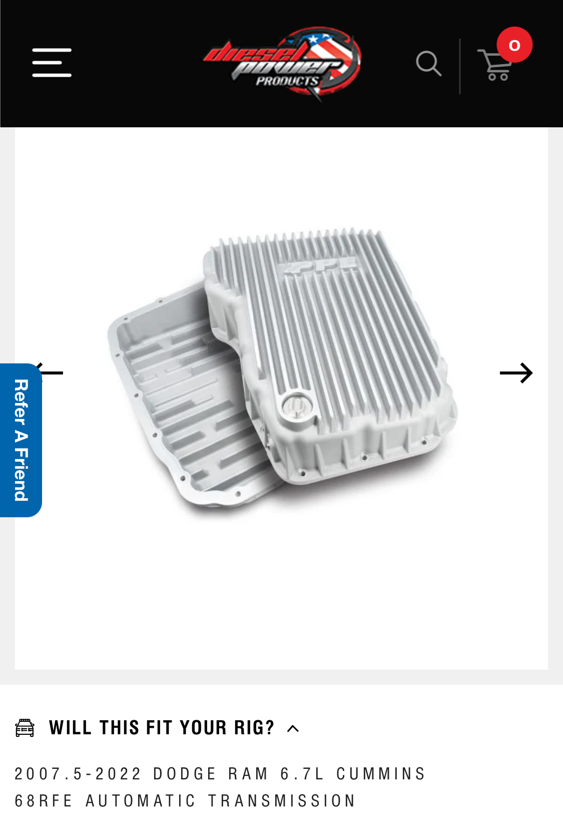

WWDiesel wrote:
Add the PML deep sump oil pan, it makes a huge difference with the having the extra quarts of ATF especially when towing and / or hot weather driving.
Will this one work also:
https://www.dieselpowerproducts.com/p-13752-ppe-heavy-duty-trans-pan-075-18-67l-dodge-cummins.aspx
PostPosted: Mon Apr 29, 2024 4:14 pm
Posts: 7380
Yes that one should fit according to the transmission number.
If you want the very best & reusable pan gaskets, get yourself one of these:
LubeLocker Transmission pan Gasket LUB-LLT-CRFE
https://www.lubelocker.com/products/chr ... e-llt-crfe
I ordered the lubelocker gasket to go with the new pan. Hoping that keeps the temp down with the loss of the OEM cooler (but addition of the Derale units mentioned earlier in the thread).

WWDiesel wrote:
Part Number 10304
I installed the new pan with the Lube Locker. Will take on a trip this weekend. The test drive is highly impressive and the trans is running much cooler!!!
That is the output of the transmission.
That is the temp of the fluid in the pan.

I did the PML pan only. Towing my boat in 78F ambient temps up long winding mountain grades where top speed is only 40 mph my pan temperature never exceeded 150F. The Dalles, OR getting stupid hot in the summer so I'm interested to see what I'll get towing when it's 110+F.
