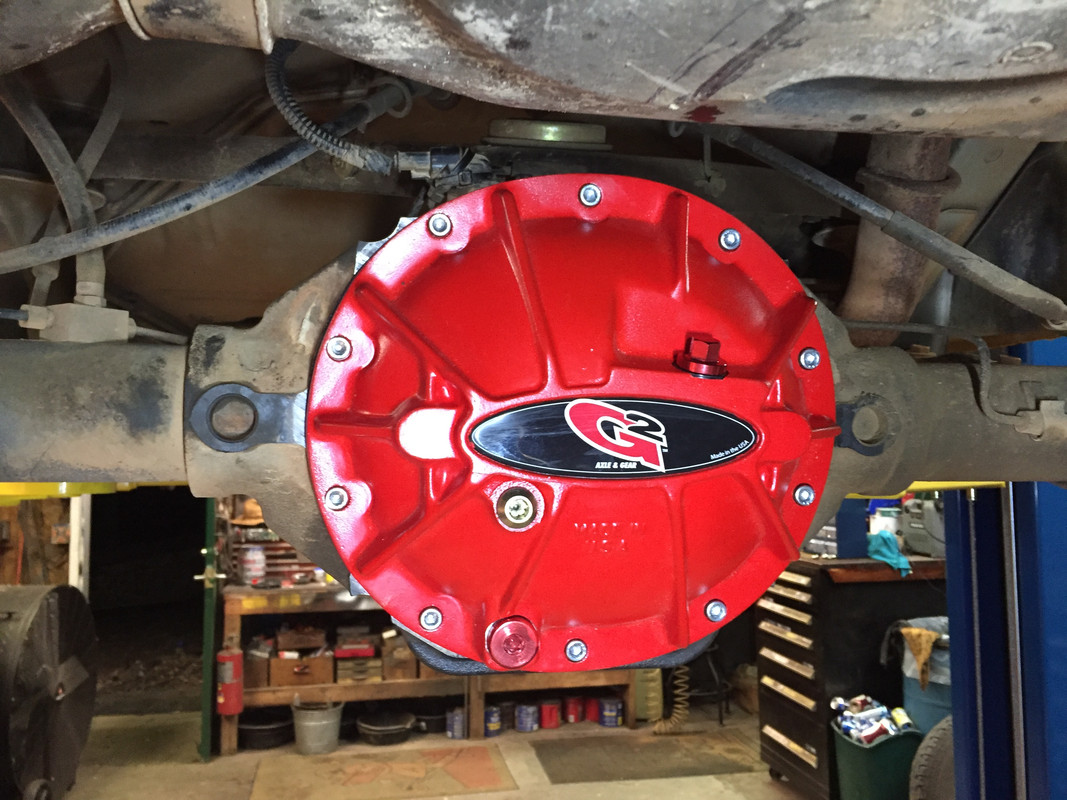

But if you would like something a little less beefy and less expensive, you can shop around and find a G2 Axle & Gear Cover for much less.
It is all aluminum with cooling ribs, a filler plug with dipstick, a drain plug, and an oil level indicator plug, all with O ring seals.
G2 Axle Rear Differential Cover for Chrysler 8.25-Silver; 40-2029AL :google:

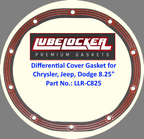

I have one on my Jeep along with a Lubelocker Gasket, it is the best gasket you will ever purchase and use.
LubeLocker Differential Gasket for Chrysler 8.25" Rear (Part No. LLR-C825) :google:
