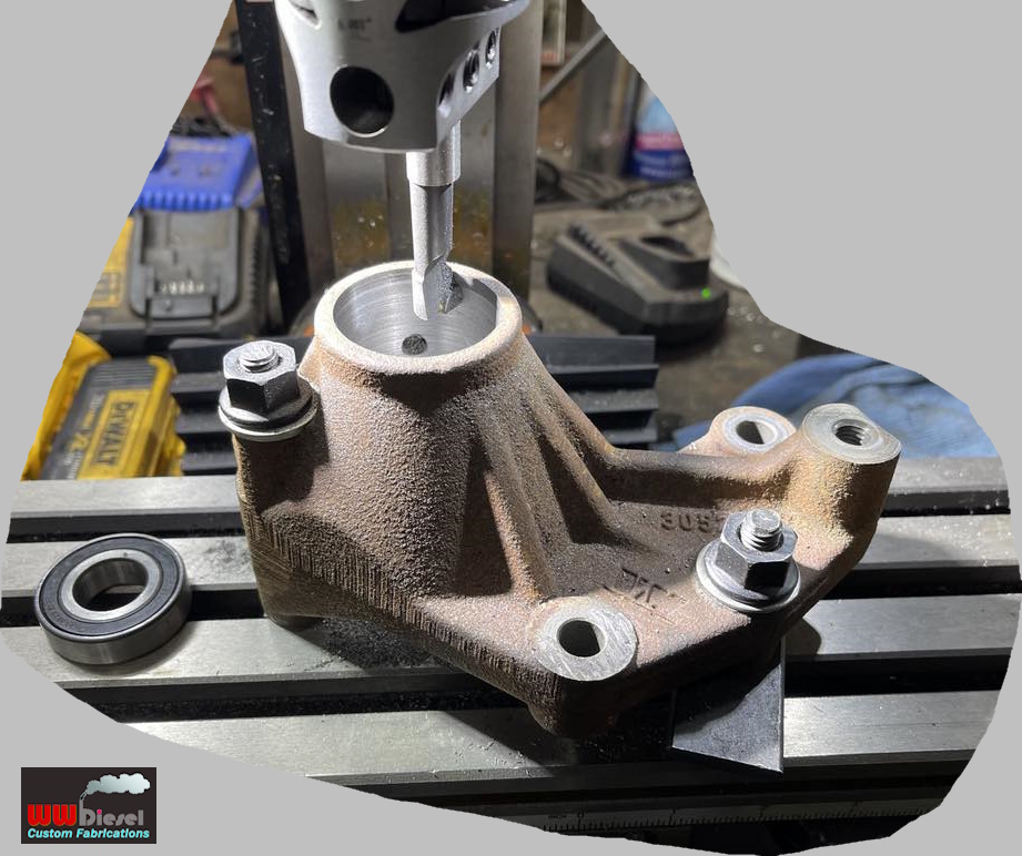

Anyone want to send me their old steel fan hub, I can rebuild them using oversize bearings. Requires boring housing out to fit new bearings.
Message me if interested. About half the cost of an aluminum one.

I sent in my fan hub to be rebuilt by WWDiesel and could not be happier with it! :BANANA:
