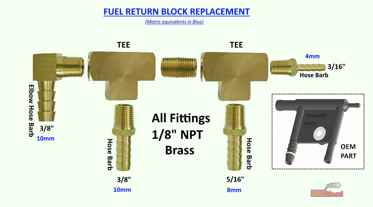

Pulled the hose off the regulator at the end of the rail and no fuel came out. But I did manage to break the little nipple for the injector return line to that plastic return manifold.

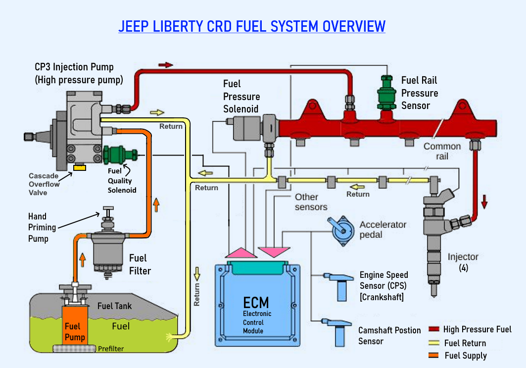

P0087 -- Fuel rail/system pressure – too low Fuel pump, fuel pressure regulator, fuel supply pipe blockage, mechanical fault
Since you lost a belt earlier, make sure the IAP Sensor did not get damaged or become unplugged. It will make an engine run very poorly.
IAP sensor – OEM part no.: 05101120AB (intake air pressure sensor on side of airbox)
air inlet air pressure comparator pressure sensor on the side of the air box;
sometimes referred to as the “Mercedes sensor”
• Bosch part no.: 0261230189.
• Mercedes OEM part no.: A0051535028
• AutoZone part no.: 0261230189
    POSSIBLE AREAS TO CHECK:
    1.**Air in fuel - leak on suction supply to CP3, stopped up fuel filter, etc... Inadequate fuel supply to CP3 will prevent injection pump from supplying proper fuel pressure to fuel rail)
    IF the CP3 is returning too much fuel.
    2. Cascade/Overflow Valve (on top of CP3) Regulates lubrication to internal parts of the injection pump and regulates the fuel pressure to the fuel quantity solenoid valve on the back of CP3 injection pump. Also, controls the amount of fuel being returned back to the fuel tank via the fuel return line.
    3. Fuel Quantity Solenoid (on back of CP3) [Also referred to as the Fuel Control Actuator or FCA ] The Fuel Control Actuator solenoid valve is a pulse-width modulated valve that controls the amount of fuel sent or delayed to the high-pressure pump elements inside the high-pressure pump. If all of the above tests pass and rail pressure is still below spec, try unplugging the Fuel Control Actuator Valve (FCA) on the CP pump and see if the rail pressure increases, if not, the CP3 injection pump could be bad internally.
**No. 1 cause of No Start Condition!
Both the FCA and the Cascade Overflow valve are replaceable and available online for purchase.
FCA: Mopar: 5159962AA Bosch: 0928400822
Cascade Overflow valve: Bosch: F00N200798
As to the fuel return plastic block, you can make one out of simple brass fitting from any hardware store, see second drawing below.

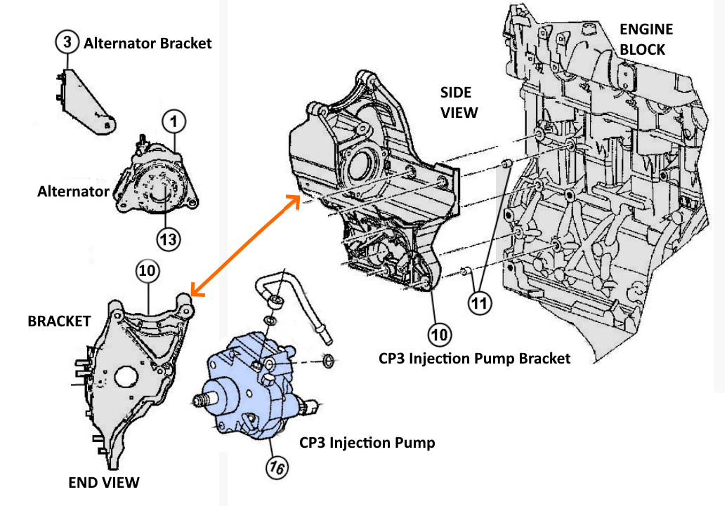

The mechanic in Tucson just told me that the only the CP3 pump is returning too much fuel. He suspects the Cascade Overflow Valve which he can source locally. He did say that unfortunately he can't access the valve because it is behind the bracket that mounts the pump and alternator and is a huge job to remove.
I have suggested that if he can get access is to cut or drill access through the bracket so he can remove the valve. Has anyone ever done this before? I'm not too concerned about the bracket as the alternative is major engine work for a $30 valve.

The CP3 bolts to the front of its bracket and that bracket bolt to the side of the engine block. The alternator and its bracket is easy to remove to gain access to the top of the CP3 pump. It is a seperate bracket from the one the CP3 injection pump bolts to.
