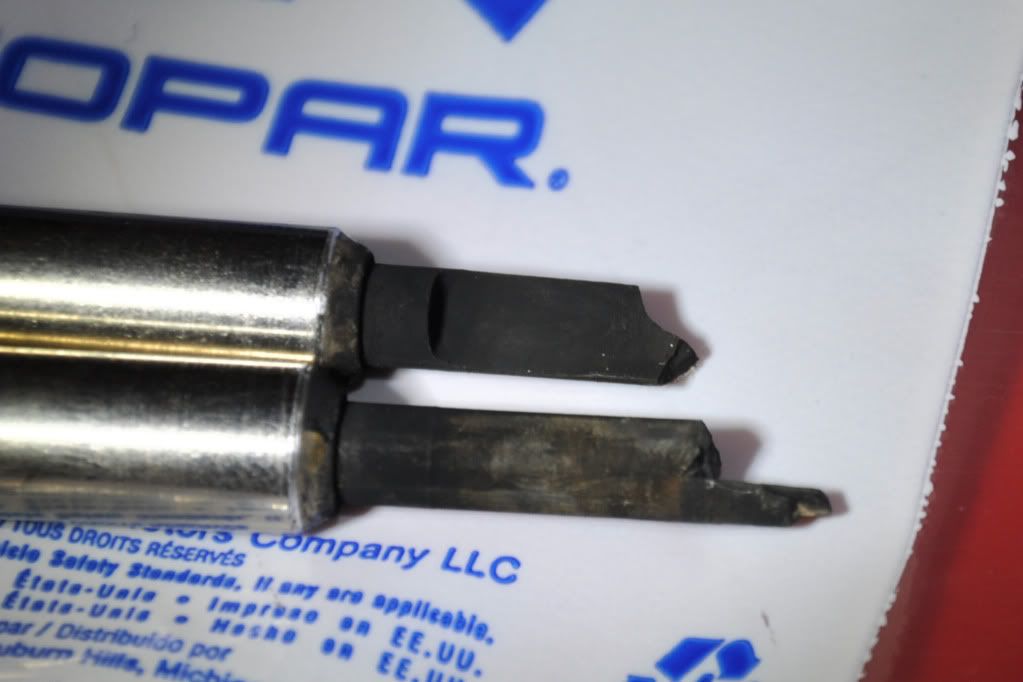

Been having a check engine light for a while. I forgot the p-codes but the text associated was something like, 'Glow plug #1 circuit or plug fault' and 'Glow plug #2 circuit or plug fault'. No big deal it's summer right?
Service info says to...
1) try replacing the glow plug control module (looks like a relay on steroids). Backordered for two weeks, got it - no luck.
2) try replacing the ECM - no luck.
3) inspect wiring - no visible issues with wiring and I don't have the proper probes to check the engine side of the harness.
4) take it to dealer for new glow plugs.
Estimate was $220. Since taking out the front two glow plugs entails removing the alternator I said go for it.
Well...
Evidently it's a somewhat known issue that those particular diagnostic codes usually mean a problem not with cyl 1 or 2, but with cyl 3 or 4. A significantly more labor intensive process to remove and replace at $90 per hour. So I went back to the dealership prepared to give the usual righteous indignation flare about a bill suddenly tripling the estimate.
To my surprise, they swapped out #3 and #4 for $225. (Somewhat) happy me! At least I'm not out a complete fortune, and I would have been far more upset if I had done it myself and swapped out #1 and #2 only to find out the code was wrong!
Looking at the removed parts, it's a good thing they aren't in the combustion chamber any more...
I can only assume the disappeared pieces were ejected out the exhaust valve and are now clogging my cat.

That's what one of my glow plugs looked like when I pulled it. Danoid, can you remember if the codes first popped after moving the jeep a few feet and turning it off right away? Like less than a minute running?

Mine is correct also and FWIW all three that have been changed so far have been cracked from the tip to about 15mm down the length of the ceramic but no missing fragments.

The new code required for fast metallic glow plugs will trash your tune. But this is easily remedied through your tune supplier. Bosch discontinued the ceramic glow plugs for a valid reason...they can catastrophically fail. When metallic glow fail, they may deform a bit, but not fracture and fall into the combustion chamber.
