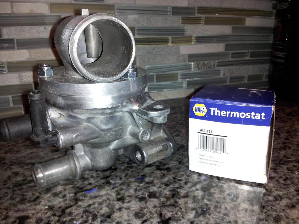

The Kaps original design drawings for modifying and making the OEM thermostat housing serviceable are available online if anyone wants or needs them.
See this:> https://www.jeepkj.com/threads/diy-serv ... tat.59804/
You will have to have access to some serious meching equipment to make the necessary parts and modifications or pay someone to do it for you.
Uses the Dodge Hemi thermostat in the modified housing.
But would probably still be cheaper than the other $500 option.
Picture of a modified and serviceable housing/thermostat:
This the route I took. Modified the factory thermostat housing and installed a hemi 192 degree T-stat and it works great. Plus it only costed me a 6-pack!
The are a couple of problems with this design. The first is that the chamber size of the O.E. housing is not appropriate for the HEMI thermostat valve.
There is no way for anyone outside of a cooling systems engineering laboratory to determine what the appropriate size of the chamber should be, other than to measure the chamber size of where the HEMI thermostat valve would normally be in, and that is in the water pump of a HEMI V-8 engine. I measured the size of that chamber and determined that the O.E. thermostat housing would not be correct, so I went with an entirely new housing and cap with the exact same size dimensions for the chamber of the Hot Diesel Solutions Model 001 engine thermostat assembly.
The second problem is that welding 6061 T6 aluminum to cheap aluminum castings can present problems. If the weld fails, then you will have a catastrophic failure in the cooling system. This will in all likelihood happen in a high demand situation that can result in an overheat of the engine, which would in turn likely result in a head gasket failure.

For what it's worth, the design I was referring to is the original design that used a thermostat out of a 3.3 l Hyundai engine or something like that, way back in 2010. This is the one that I have. I didn't realize anyone had redone his design with a Dodge hemi thermostat.
viewtopic.php?f=98&t=50940
This unit has worked fine in mine, I live in Hawaii, and can't remember the last time I exposed the Jeep to the summit of Mauna kea. The coldest it has seen in the last 4 years is probably about 55° f at startup when I went camping halfway up the mountain. As for heat, it's very uncommon for me to see 90° f here. So your mileage may vary. I know the TDS is a high quality solution. If I were to do it over, given my level of income today, I would probably have gone with that solution. At the time, money was tight and I was willing to try the cheaper options. I even had an online thermostat from meziere for awhile.
When my father bought a new welder that could do aluminum, he said let's give it a go! We did it, pressure tested it, and it's been in there ever since. The TDS is certainly a safer option.
WWDiesel:
You are confusing Mark Kapalczynski's original modified O.E. thermostat with the one you have provided a photograph for. Mr. Kapalczynski's design is bolted together with 2 - 6mm studs and uses 2 sets of gaskets in the main body of the thermostat housing. The thermostat valve is from a Hyundai Accent, the thermostat cap is from a Kia Sephia, and you need to use an upper radiator hose from a '93 - '97 Dodge Intrepid. Here is his thread; it was started way back on March 11, 2010...
The one in the photograph is from SargeIndustries, the guy who stole my idea of using the HEMI thermostat valve. I do not know where the link is to his pirated version.
