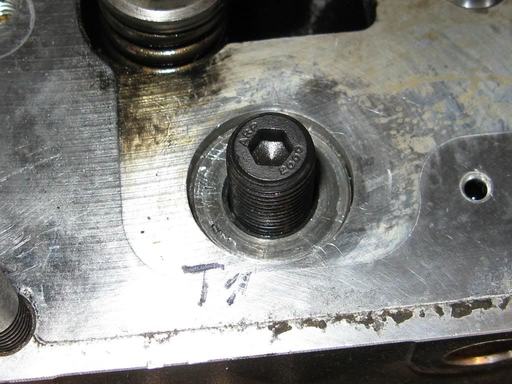

As stated above, I took some of the stud nuts off to see what they looked like.
Here is one-
MUCH flatter now! :lol: You can see where the ridge was, you can see the scratches from the dental pick I used to check the area out, and you can see the 'aluminum foil' where the head deformed locally and delaminated locally when I crushed it with the stud/washer/nut.
In hindsight, it would have been much better to have removed that ridge before using the ARP studs.
That deformation can be a problem depending on what is near the hole. One of my lifter holes needed some minor lapping to restore free movement.

It will be a few months before I get any really long hot drives, but I was losing coolant on 20 to 40 mile commutes. Now I am not. Cardboard/newspaper did not show any drips. Was this the WP or the HG? Who knows? I do know that I found significant variance in 'TTY' head bolt removal torque, and significant variation in rotation required to bring the ARP nuts to the required torque. Both of these facts are strongly indicative of a warped head, but I did not gage the head to confirm it.
Bottom line, studs ensure clamping force. I will be building the next motor with them.
