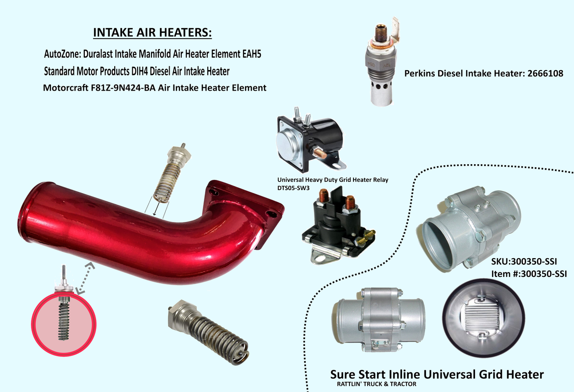

Posts: 7395
Just a suggestion!
Build your own; there are some inline air intake heaters available on line. See picture
A simple circuit using an HD starter relay, and a spring loaded momentary on SPST switch mounted on the dash, some 10ga. wire and a large amp fuse would work.
You would have to be your own manual timer as to how long to hold the switch in the on/heat position, probably 10-15 seconds would suffice depending on ambient temperature.
If you need help with a wiring diagram, let me know and I can draw one.
You will need a very good battery to withstand the current draw of an electric grid heater!
The screw in heater could be mounted in the FCV or in the metal elbow pipe if the EGR system has been removed.
Or use the inline type that mounts between boost hose and intake.

Yes WW, a diagram for the wiring would be awesome! I've seen some of your other posts with them, and I'm sure they've been a huge help to the requestors. Actually, I posted a thread previously about the in-line intake heater but didn't get any bites in reply, so am glad that you replied to this one. If you don't mind, plz give a recommendation as to which one (screw-in versus in-line) you'd go with. I know that Sasquatch offers a mount for a larger battery, and I might go with that too. Outside of that mount, do you or anyone else have any suggestions on how/where to mount a second battery?
THANKS in advance for the help!
