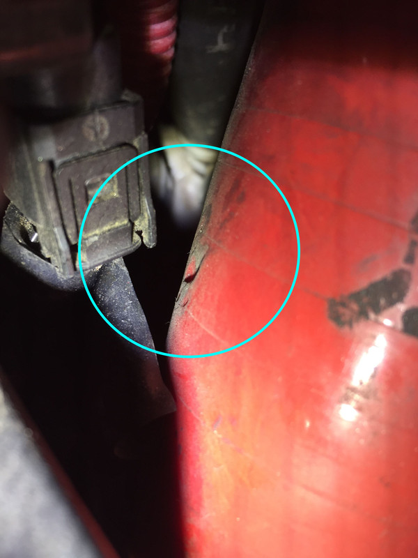

Spot was worse than I thought! :shock:
casm give yourself a big pat on the back for identifying this problem! :-)r You probably saved me a boost hose and maybe some others.
Probably need to start a new post on the tech section about this issue? :idea:

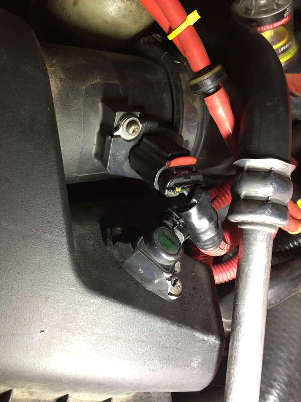

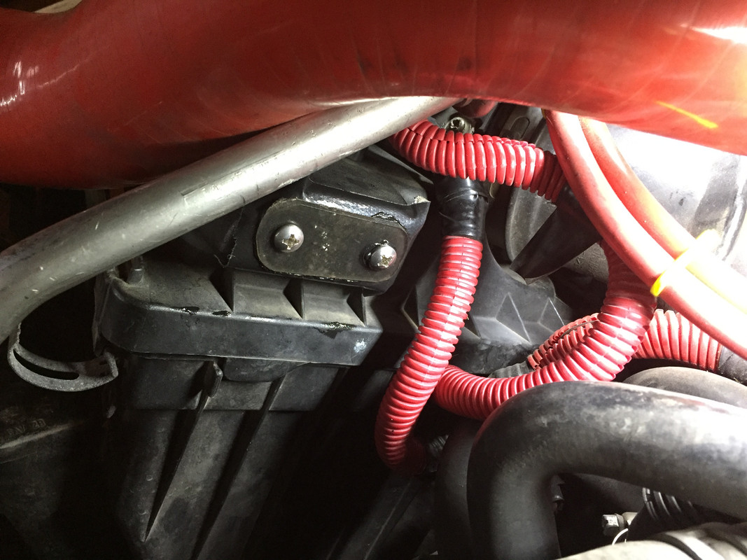

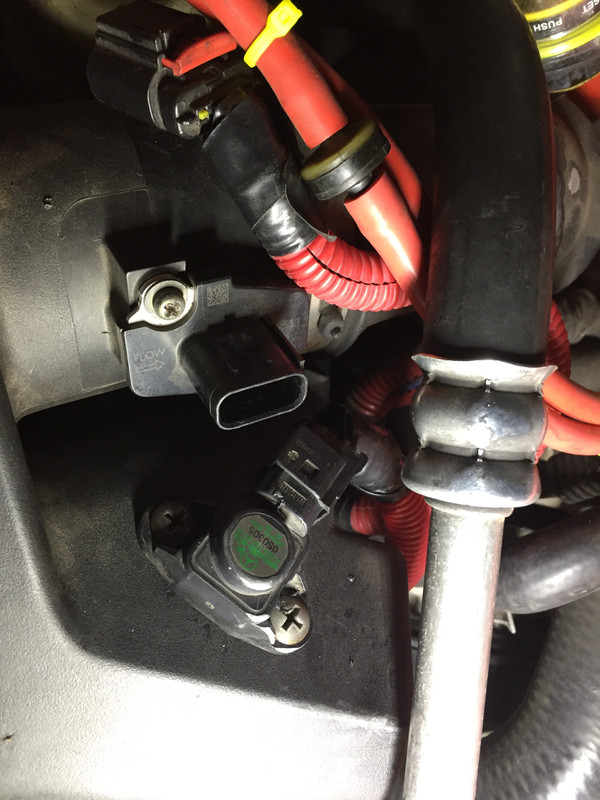

I first tried simply removing the two screws that hold the sensor and rotating it 180 degrees, but it kinda put the wires in a bind and I did not like that.
Pictures by number
1.Here is what I found and how I fixed it so it never happens again. I did check on the inside of the boost hose and luckily it had not worn all the way through yet.
2.Moved the air box sensor to the top of the air box. 2 pictures showing move and wires connected to it and MAF sensor.
3. Blanked off the OEM location using some silicone sealer, black Gorilla Glue duct tape and a piece of lexan.
4. Final showing where I filled the small worn spot with silicone sealer and then wrapped it with orange Gorilla Glue duct tape.
Your photo (below) is an almost 100% match for what I found on mine earlier. Not sure how well I'll be able to show the issue when I remove the hose in ours as it's black so the wear spots are harder to make out, but, using your photo for reference:
The big nick in the hose is where I was finally able to spot the crack on mine. I don't recall seeing another nick above it, but there certainly was one matching the one below it in the photo.
I'm happy to be the guinea pig? :ROTFL: Seriously, though, if this does help other folks to save their hose or prevent the problem happening in the future, I'm all for it.

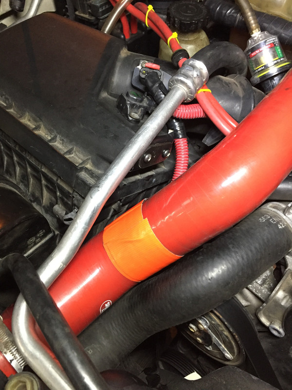

Previous owner of mine mentioned the hose was rubbing there, he had duct-taped some plastic cards around it. I thought he said he had done so after replacing the hoses, but now I wonder! I did take the hose off and inspect it once, I couldn't see any damage inside, but I didn't pull his tape off...
Maybe it was worn before and finally failed? I'll have a closer look next chance I get. On the other hand, temps dropped from mid-90's to low 80's and it made a huge difference. Still there a bit, but much more responsive today.
Out of curiosity, did he replace them with silicone or more of the OEM rubber hoses? I have a theory regarding which one will wear faster, but would be interested to hear what you have to say on that.
BTW, you might not actually see anything without removing the tape. It can be hard to spot depending on how the wear took place.
Same here; we're down into the mid-70s this week and that's made a very noticeable difference.

I like how you did that, and am now considering the same idea. What size drill bit did you use for the 'snout' on the air pressure sensor? I want to make sure that that sucker seals down as tight as it did in the original location.
I used a stepped unibit and drilled one step up at a time until I was able to push the sensor in the hole for a snug fit.
Used two #10 sheet metal screws to fasten sensor to box.
The sensor does have a little small "O" ring on it which I put a little vasoline on it so it would slide in easily.
I did measure the part that sticks into the air box and it was a little over 1/4" just under 5/16". ~9/32".
If you have not got yourself some stepped unibits, get some, one of the handiest drill bits I ever used. Love them! :BANANA:

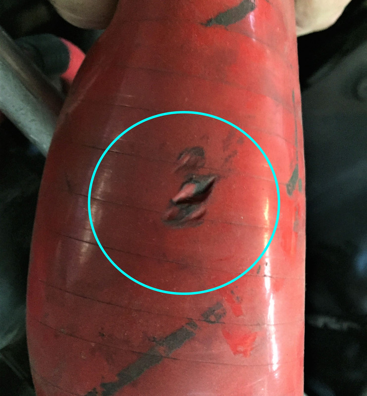

Parts (replacement Samcos and a Sasquatch silicone airbox-to-turbo hose) arrived during the week. Despite getting our first sub-freezing night of the season last night, it was 70°F this afternoon, so I went ahead with replacing known and potential problem children.
Couple of notes:
Sasquatch's silicone airbox-to-turbo hose ships without an elbow for the CCV hose. This isn't a big deal, because in theory you can reuse the one attached to your OEM hose. However, when I got my OEM hose out, I noticed a crack in the elbow (yay, another air leak!) that I hadn't picked up on before. Replaced the elbow with a Dorman 47043 unit from Autozone; it fit perfectly with plenty of space for hose clamps to bite into. No idea how longevity will be once it starts seeing some heat and vibration, but we'll see how it goes. FWIW, the crack was on the back side of the elbow, nearest the turbo heat shield. Makes sense that that would be the weakest point.
Double-checked the turbo impeller shaft while I was in there. It is absolutely dead-centre solid. As much as I'm looking for an excuse to upgrade the turbo, now is not the time to have to do that so I am incredibly relieved for it to still be in good health.
The turbo-to-intercooler hose had definitely worn through where it was rubbing against the air pressure sensor. It was a small but significant tear, and it's obvious as to how that would have been impacting performance and economy. I am planning on doing WWDiesel's air pressure sensor relocation mod to the airbox lid in a couple of weeks, but as I'm heading out on yet another 2600-mile round-trip on Monday, don't want to do that one until I'm back home with a full complement of tools and a spare vehicle to drive :wink:
Have not replaced the intercooler-to-manifold hose; I'm housebound this evening while other things happen, so the time to undertake that just isn't here today.
