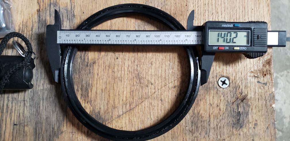

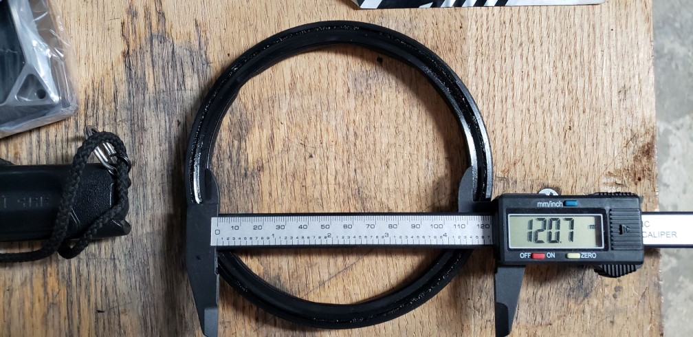

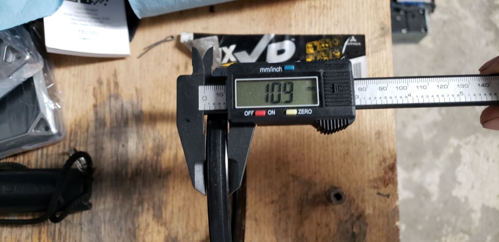

layback40 wrote:
If you still have the rear main bits out, could you please measure the RMS. The OD, the ID & the thickness. If it has any numbers on it, knowing what they are would be useful. I want to see if its the same size seal as the the 425 as I have a spare.
Thanks
I do, and I can!
Thanks

Thanks for that. It looks larger.
I will have to dig the spare one of mine out now.
Thanks for the motivation!

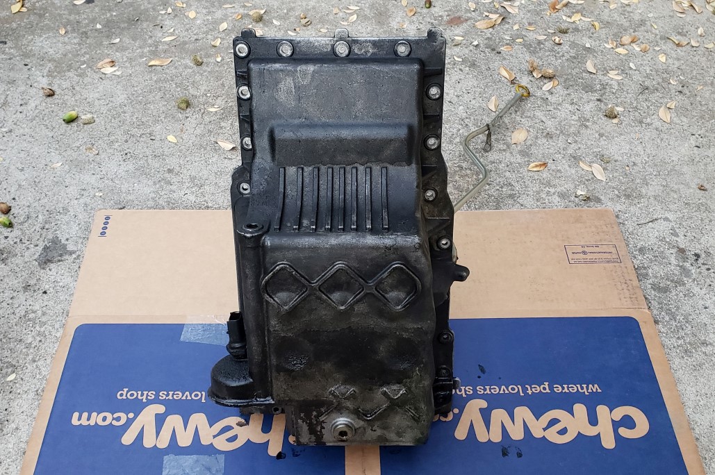

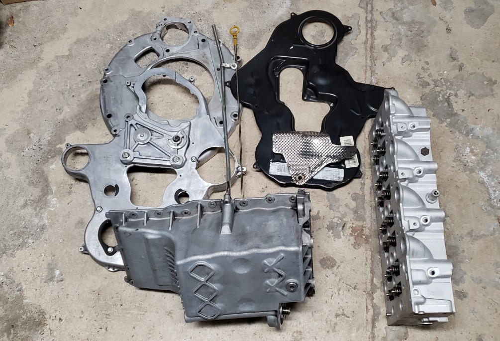

I wanted to give an indication about exactly how filthy this motor is. Pretty much everything looks like this:
Oil everywhere, and the PO pretty much kept it in the dirt... he was a tow truck driver / nut rancher (???) and when he wasn't using it to jump start stranded vehicles, he was using it in the orchard... so all the oil attracted a lot of dirt and muck. It's pretty gross everywhere.
Since I'm waiting for parts, I figured I might as well make my future life easier:
Still more to do, but at least I'll be able to see the leaks clearly next time. :|

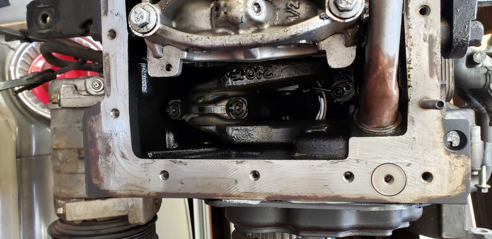

PostPosted: Sat Nov 16, 2019 6:20 pm
Posts: 652
Where is the oil pressure sensor that OBDII reports? Is that the sensor on the back of the oil filter housing? If so, I wonder if there would be value in using a mechanical gauge somewhere else - maybe one of the oil galleries along the block?
15psi warm seems like perfectly fine oil pressure, but 8psi cold is alarming. That, to me, sounds like an oil pump issue, although I had a similar problem on a Volvo which turned out to be a failed o-ring between the pump and pickup... I think cold thick oil enticed the pump to suck air through the o-ring but once things warmed up the pump was happier about taking in oil as it should.
Here's the valve:
You can see it's inline with the oil pan flange so the pan would have to come off.
