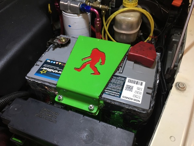

As to the battery: IF you replace the stock battery with a very good group 65 AGM, you should be able to get by with a single battery. See my gp. 65 battery installation picture below.
Since there is very little extra room in the engine compartment to fit a second battery, you could put one in the rear cargo area in a sealed battery box and use large battery cable wire to run the supply all the way to the front engine compartment. See Picture No. 2
Keep in mind, there was one member on this forum who actually fitted two batteries where the current battery sets, but I could not find his post with pictures.
Personally I think one good very high group 65 CCA rated AGM battery should work just fine. If I wanted a lot more CCA rated battery, I would consider trying to fit a group 31 battery, they have some impressive numbers. :D
Group 65 Battery installed.
Picture No. 2, Sealed Battery Box

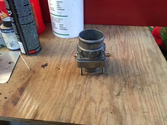

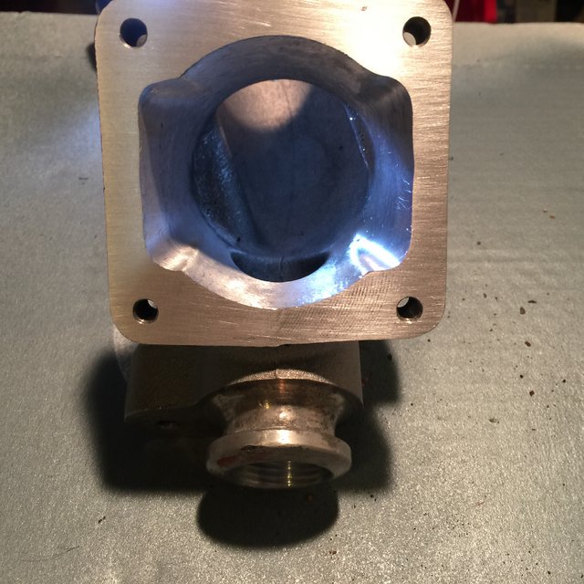

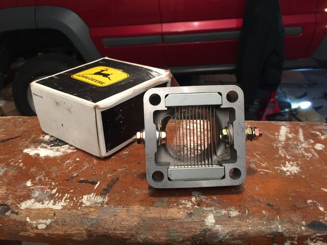

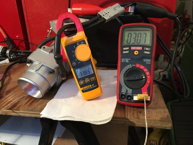

Hi Kids, I've been away from this forum for some time, life got in the way of my CRD project. I've gone down the grid heater rabbit hole and this is what I found.Image ImageImageThis heater is from a compact tractor. The footprint is the same as the FCV.ImageThe problem is that teeny tiny hose connection.Image The solution is to remove it. I don't have access to a milling machine, so the correct size hole saw will have to do.ImageImage Now we need to port match and drill and tap the elbow for a boost gauge and thermocouple.Image ImageNow we test it.Image I think it has potential. 300 deg F at 34 amps of current draw. This will replace the FCV in my CRD. EGR delete,OMG, call the EPA.

If that is the same size and bolt hole distance as the flange on the intake manifold/valve cover, could it be sandwiched between the intake flange and the FCV delete elbow that many now have?
A lot of owners no longer have the OEM FCV elbow.
But it certainly looks like it has potential.
Any ideas on cost for heater?
 Post subject: Re: Grid Heater Project (Proof of Concept)
PostPosted: Sat Aug 13, 2022 9:58 am
Joined: Sat Dec 11, 2010 1:01 pm
Posts: 12
Green Farm Parts shows them for $66.10. Some places show a newer version, different part #, $100ish. I started fooling with this in 2015. I wanted something that could replace the FCV and was plug & play. At the time I wasn't aware of any kits, plus I already had the heater for my tractor.

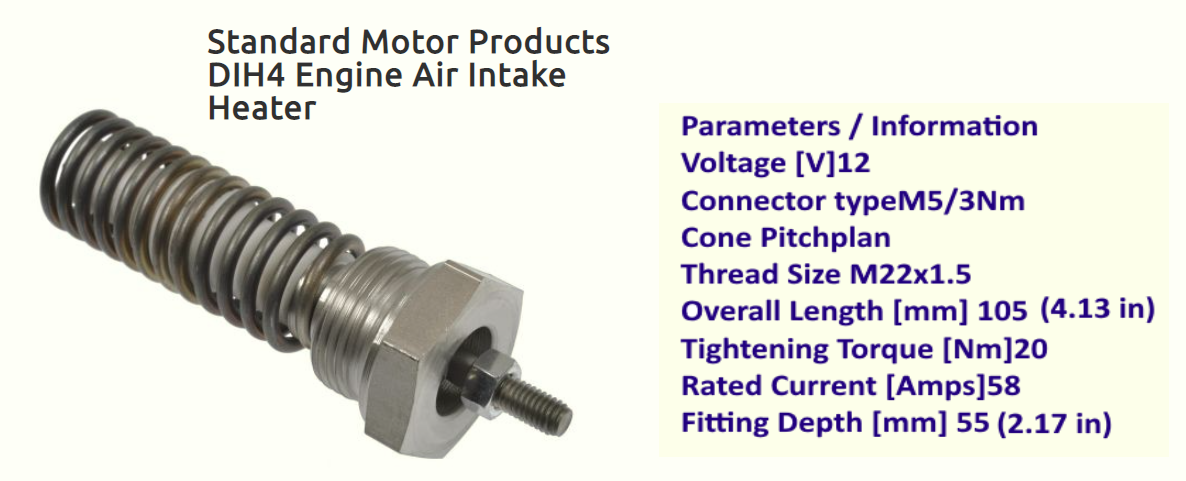

STILL pushing this noodle up the hill, it seems... I have a Standard Motor Products (SMP) DIH4 screw-in heater, and need the thread size and pitch for it. I called SMP, and they said "...we have no specs on that item...". Does anybody know the thread size and pitch for it?
PostPosted: Wed Sep 21, 2022 1:30 pm
Posts: 7395
The thread size of the IAH is 22mm x 1.5mm
NTERCHANGE for Standard Motor Products (SMP) DIH4:
Airtex: 1S12230
Duralast: EAH5
Isuzu: 8972519740
CARQUEST Premium By WELLS: 53-21605
General Motors: 97251974
Echlin: AIH101
BWD: AIH104
