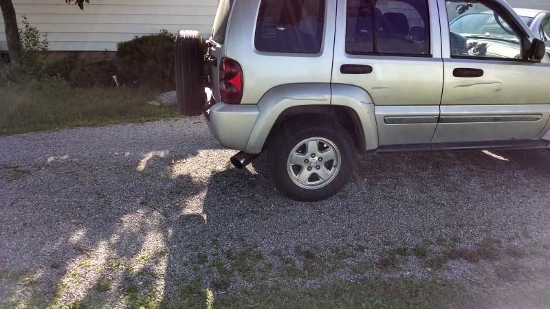

Well got the exhaust done and took it for an 8 hour road trip to see how she felt.
Initial thoughts:
The power is up high, ~2500 rpms. When you want to accelerate it feels like you gotta give it more pedal than normal.
Since the power is up higher, its perfect for on ramp accelerating and passing. 40-80mph happens quick.
Very fun to drive now and the turbo whistle going through town is loud. Have had several people tell me it sounds like a truck, and asked if it was a Cummins.
Gonna drive it like this until I get the 2560 built. Then I'll throw that on for comparison.
Here's some pics of the exhaust, went 3" all the way to a 5" tip.

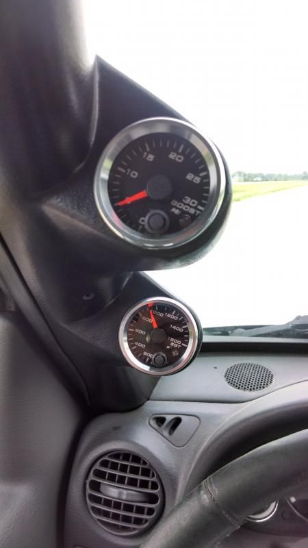

Here's a shot at 70mph cruise, anyone have gauges that can compare?

70mph cruise on my CRD (engine #2 had the gauges) I remember the EGT being about 800-900 and boost somewhere in the 8psi range. Seems you might be a bit light on the boost and heavy on the fueling at the same point?
I also had 215/85/16 tires, so taller and narrower than stock, and load range D at 65psi, so stiff and low resistance. Other than that, stock turbo, stock mechanicals, just Eco tune (an early one so I don't know if it was full torque or not) and the GDE trans tune.

There's quite a bit of quality lost in all the transferring, but the egt needle is just above 900°, like 920. Boost was right at 5. The ecu was reading 7 psi. Cruising like this was when I could tell I had a bigger turbo. Normally slight pressure on the throttle and the boost would pick up and you'd lug ahead. On mine slight pressure does raise boost some but you can hear it isn't enough to pick up and go like it should. Its more like a gas engine where you have to press on the throttle until it kicks down and away you go. I think stepping down to the 2560 will improve everything, might choke on the very upper end.
On the 400 mile trip I only averaged 26mpg :( I think this will go up when I change turbos. The lack of excess boost means more fuel is going out the pipe as heat instead of power. Ahhhh r&d........ :roll:

My boost is about 8-10 psi, I'd say it hovers around 10 mostly and egt 7-800 @ 70. Since you dropped the vnt, you may have a bigger turbo lag... But I think Geordi got it right, may be a bit more fuel, but if the boost is so low, you may need the extra fuel to compensate. 26 mpg isn't bad, I think you were stepping on it quite often to hear the noise, lol. Also, what's the max boost observed on normal (not pedal to the metal) acceleration?

Probably 15 psi. Once you get past 2500rpms and you keep pushing the pedal, the turbo really lights up and hits 28psi, accompanied by a nice compressor whistle :D . trying to upload a video to YouTube now of a startup. I'll try to get a video messing around in it.

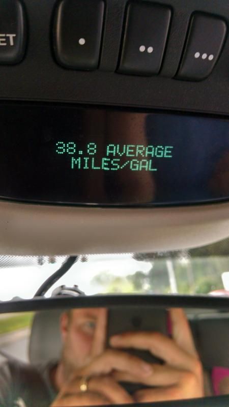

Did a 60 mile round trip today, 60 mph with no wind, no ac and got this:

It was actually pretty easy to get 40mpg, I didn't let it rev over 2k rpms, no more than 5 psi of boost, an kept egts at 800 or below. Put just shy of a hundred miles on it today and still above the full mark on the fuel gauge. Would love to see what it would do with more fuel efficient tires.
