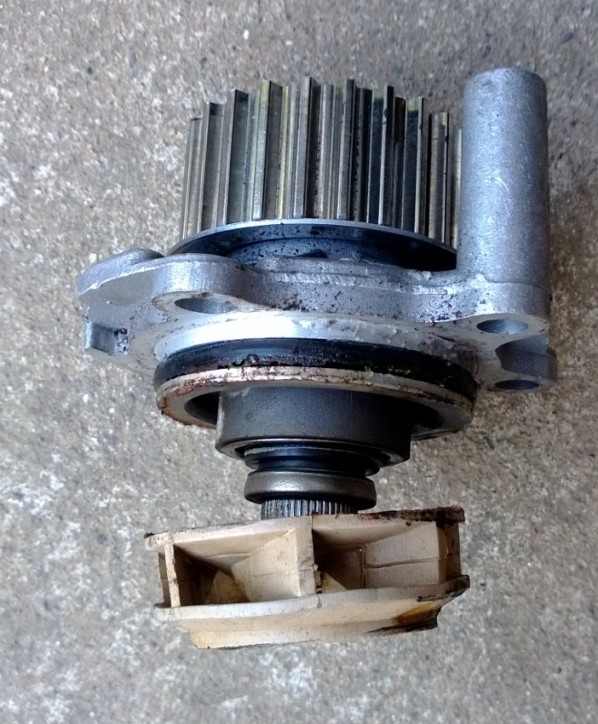

 Post subject: Re: Well, here I go... pulling the motor.
PostPosted: Mon Nov 18, 2019 4:36 pm
Posts: 561
Location: Australia
thesameguy wrote:
Sometimes worn bearings can cause low oil pressure - had an Audi with that problem. It was otherwise fine, but when the engine was hot oil pressure would drop very, very low. I believe it's some Mercedes diesel motors where damaged oil jets cause low pressure for the rest of the motor. All the Y2K-esque sludgy motors (Toyota, Audi, Saab) would "create" contaminated oil from ineffective PCV systems that would turn to sludge and obstruct the oil pickup. That was one of those worse when cold scenarios. On turbo motors proper PCV is positively *critical* - you gotta deal with that increased blowby.
IMO, the bypass valve theory doesn't hold water as it would tend to get worse with heat, not better, and it's probably mostly an all-or-nothing type affair.
My money is on the pump - it's either worn and not doing it's job, or its pickup has a problem and there are delivery issues.... a damaged o-ring, a clogged screen, etc. I would hook up a mechanical gauge to double check the sensor, but I'd wager that pan is coming off.
The early V8 Toyota Land Cruisers in Australia had a plastic oil pickup pipe & strainer. When they were worked hard like towing a van, it would soften & over time starve the engine of oil. I know an engine rebuilder that made a lot of $$$ out of that problem.
Australian KJ CRD 2006
PostPosted: Mon Nov 18, 2019 5:31 pm
Posts: 652
I LOVE IT when manufacturers take something tried & trued and modify it in a totally nonsensical manner and then hand if off to the consumer.
Plastic oil pickup has gotta be at least as bad as BMW's & Audi's idiotic fascination with plastic impellers on water pumps. Turn something totally reliable into a maintenance point that is pretty darned likely to just totally blow up your motor.
PostPosted: Mon Nov 18, 2019 8:41 pm
Posts: 4962
You will find that the factory CRD water pump also has a plastic impeller.
Although it’s proven to be quite durable.
I didn’t change mine till 160k miles. And it was still in good shape and not leaking.
U.S. Army Retired
PostPosted: Tue Nov 19, 2019 2:42 am
Posts: 1128
Location: Jackson,TN
I didn't change my water pump till 2nd TB change at 180,000 but I do like the Metal impeller on the replacement but I remember one post where the impeller wasn't attached to the shaft (? Sir Sam). There have been some bearing failures though which in itself isn't that big a deal but they caused slippage of the timing belt. Its all a problem of design give and takes.
