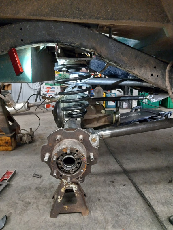

Here is a pic of it mocked up a couple weeks ago before I sent it in for powder coating.
I am pretty anxious to see how it drives!!

Cool, is that the original FJ axle?
1998 XJ 4.0L, 2" lift
First Jeep: 1962 Willys CJ-3B
 Post subject: Re: 2005 CRD swap into fj40
PostPosted: Mon Apr 10, 2023 10:00 am
Joined: Sat May 29, 2021 7:59 am
Posts: 138
Location: Central Minnesota
Not anymore. I found a full float from an fj60 that I picked up to use. Mainly because I wanted an Eaton Electric locker. And they won't work with a semifloat.
