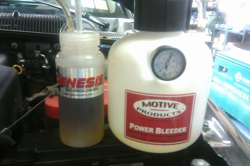

Did this to both Jeeps
Used this to test the fluid
http://cgi.ebay.com/ebaymotors/_W0QQcmdZViewItemQQ_trksidZp3984Q2em1439Q2el2649QQitemZ150616565325QQsspagenameZSTRKQ3aMEWNXQ3aIT

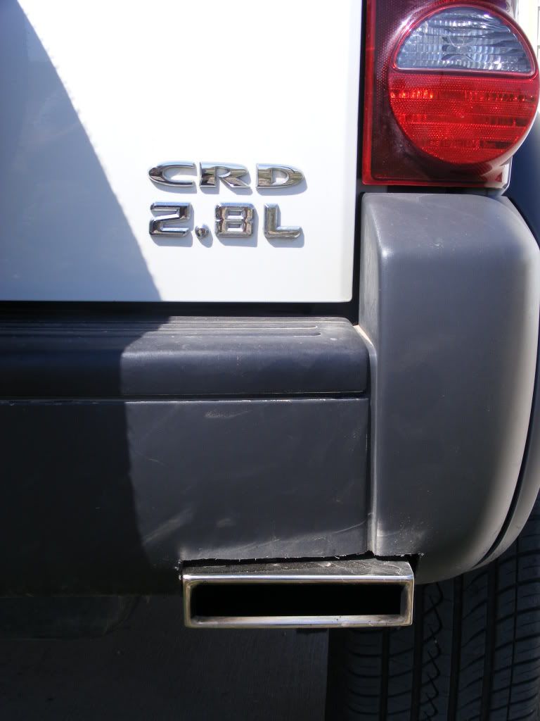

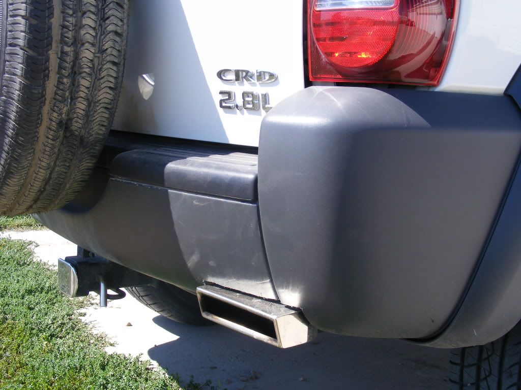

I cut the turn down, on end of exhaust, off and trimmed rear bumper to install a tip
It isn't perfect but it gave it a deeper tone, got rid of the drone inside, and a little sportier look.

Nice touch, but a file and sand paper would do wonders on the roughness of the plastic bumper. Any concern about heat in the vicinity of the bumper?

Ya I tryed a file it wasn't helping much, didn't have any sand paper. :banghead:
Was but I've been checking it in town and open road. Plastic is no hotter than if the sun was hitting it. I left around 1/4" between plastic and tip.

I too would like to know how the bumper handles the heat from the muffler.

No muffler. Drove it HARD to town (48 miles). EGT max was 1100 degrees. Plus a couple of hours of town driving. Outside temp was 92. Plastic still wasn't hot enough to take my hand away. There is a lot of air flow around the tip. Trust me I was worried too, but the plastic under, next to the stock exit didn't show any fatigue. Must have a good heat resistant plastic.
