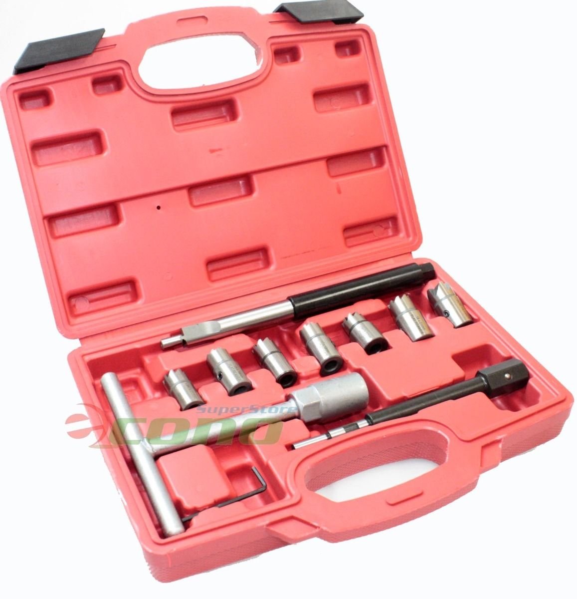

Or one of these:
10pc Diesel Injector Seat Cutter Set
https://www.amazon.com/Diesel-Injector- ... B00P2SU168
