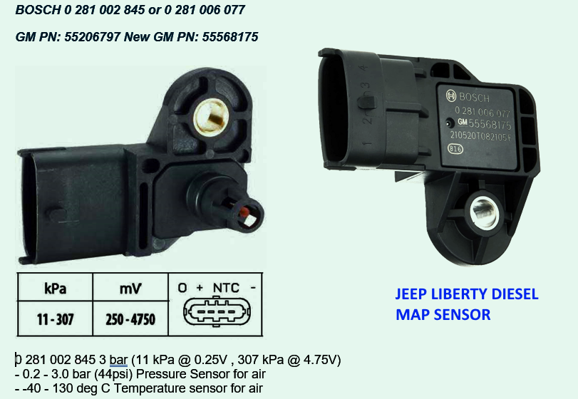

Is the map sensor in the intake manifold what reads the intake air temperature?

Yes, it is a dual sensor, it reads both air temperature and pressure. See below for specifications.
