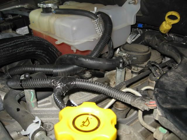

DocB wrote:
OldNavy,
With the filler material in place, did you notice any
less "smoke" coming out from under the vehicle?
I have never noticed any smoke or vapors from the mod to start with, don't ask me why as I haven't a clue.
91 MB 300D 2.5L Turbo. Her's

oldnavy wrote:
DocB wrote:
OldNavy,
And I have a ton of vapors coming out from the second it starts. Hopefully will complete the Provent today.

OldNavy,
Yes, I have the same setup, holes and all.
Smoke at idle (stopped). I guess even if it was
smoking while moving, you wouldn't see it.
P.S. Used to keep oil at close to full mark until
I found out 1/2 way was the correct? measure.
Now, oil level holds steady at 1/2 mark for the last
2K miles.
What do you think?

Thanks OldNavy,
I will keep you all posted on my oil consumption also.(or lack thereof).
By the way, regarding the EHM.
As suggested, and I agreed, I did not over tighten the clamp
that holds the PVC tubing onto the PR. Just a little movment,
in case of pressure build up.
Well, I noticed slight leakage of oil out past the hose and down
onto the valve cover! Very slight, but wet. Just enough to wet
(stain) the fingers. Cleaned it up, tightened clamp, all OK.
No obstruction in hose (I knew you were thinking that!).
Anyway, got my to thinking that there is definately positive
pressure there.
Just a thought to help us in designing a CCV valve that drains
the condensed oil vapor back into the engine.
I have some halfbaked ideas, and will keep you posted.

Making a CCV filter for this rig is rather simple thing if a lathe was out in my garage, but other wise will just have to wait till I find someone that will follow my design idea.
In the meantime my filter material is working like a charm on the EHM, will post results Sunday or Monday.

I took my EHM off after 800 miles last night and it was crystal clear EXCEPT for the first 3 inches of clear hose at the exit of the CCV - this area was filled with a large puddle of oil that appeared to be draining back into the CCV. It was a large enough amount of oil that after I pulled the hose and tipped both ends up, the oily end drained to the center of the hose coating it completely.
When returned to factory connection, I routed the CCV exit hose over the top of a small diameter coolant hose that goes to the coolant overflow bottle. This makes a significant upslope at the exit of the CCV before turning down into the intake. I think this is all that is needed to keep the oil to a minimum and as such ends my experiment with the EHM. :)
http://i70.photobucket.com/albums/i100/ ... 1165688200
