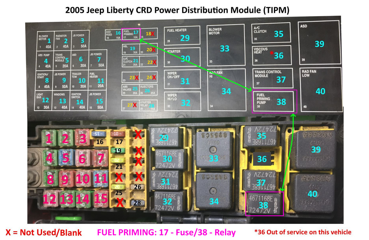

Is the intank pump running?
You can open the bleeder valve on the fuel filter head, turn the ign. key to the on/run position, and the pump should run for about 15 seconds and fuel should pour out of the bleeder valve.
If the pump is not running, make sure you have the relay installed and the fuse is good for the fuel pump.
2005 Model Power Distribution Center under the hood:
