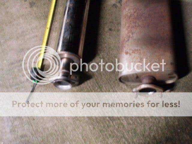

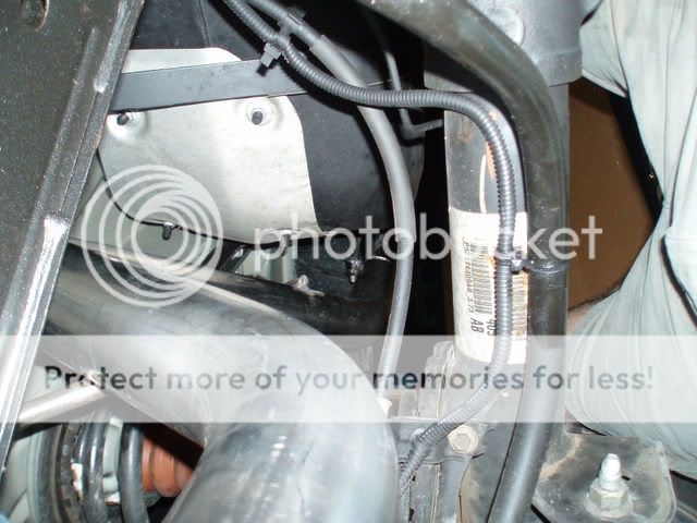

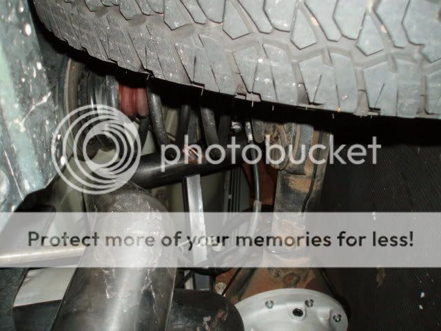

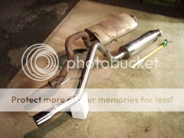

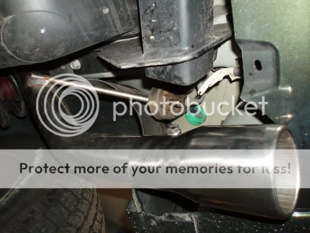

PostPosted: Sun Aug 17, 2008 11:21 am
Joined: Thu Apr 03, 2008 3:00 pm
Posts: 177
Location: Westchester, NY

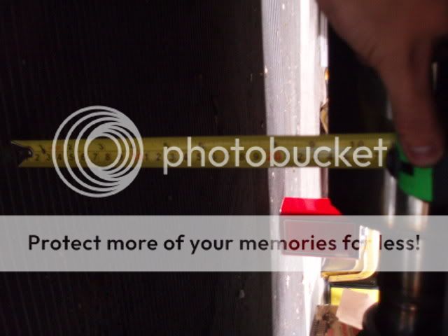

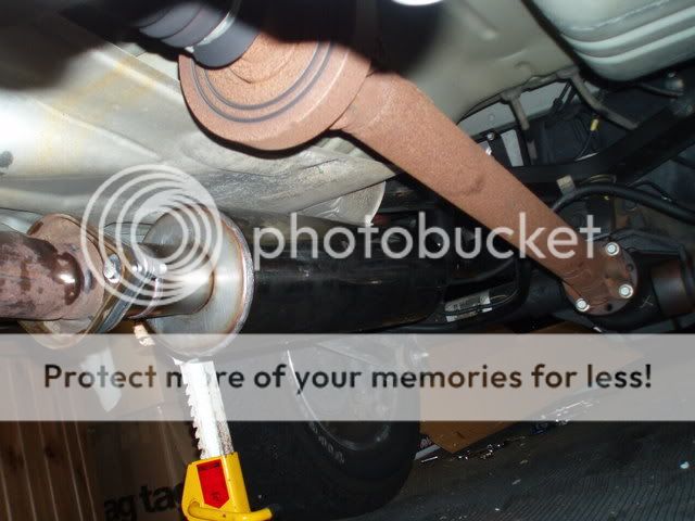

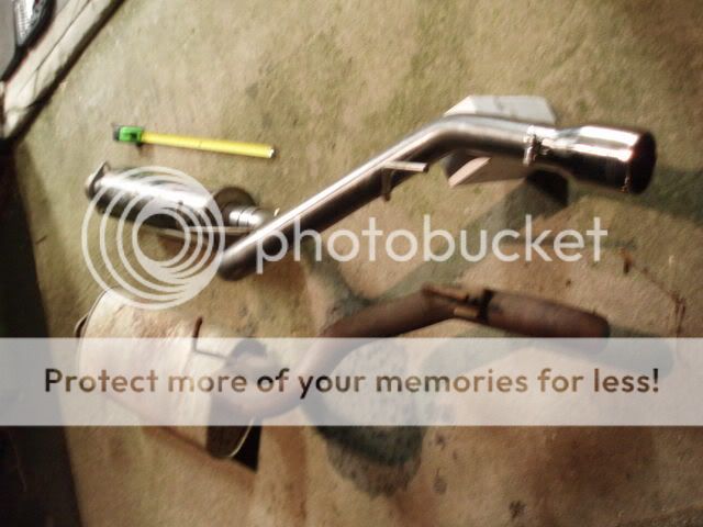

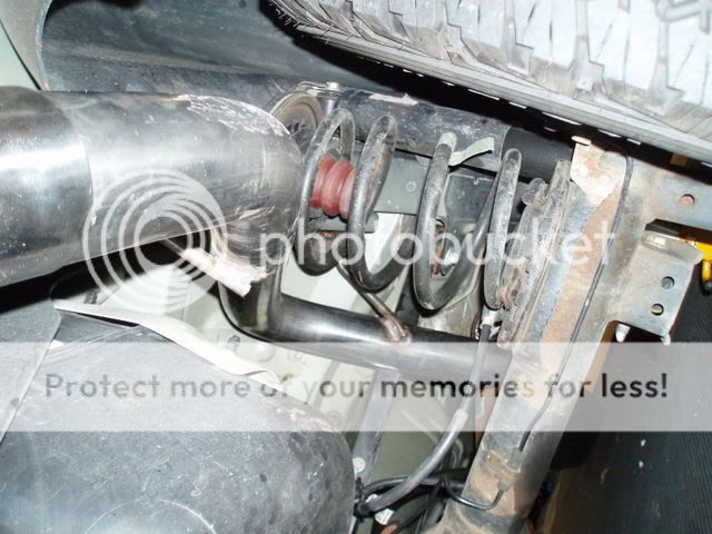

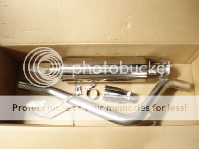

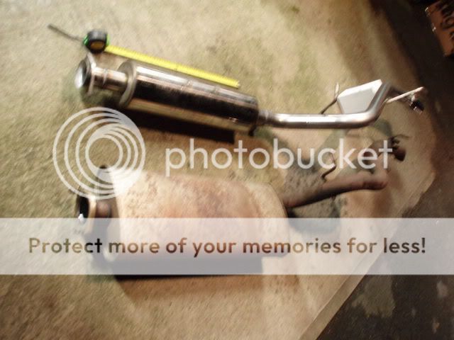

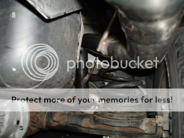

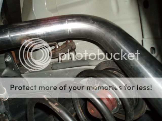

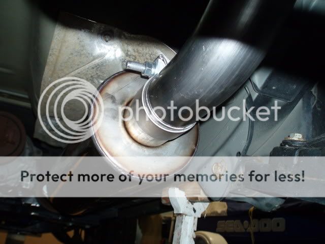

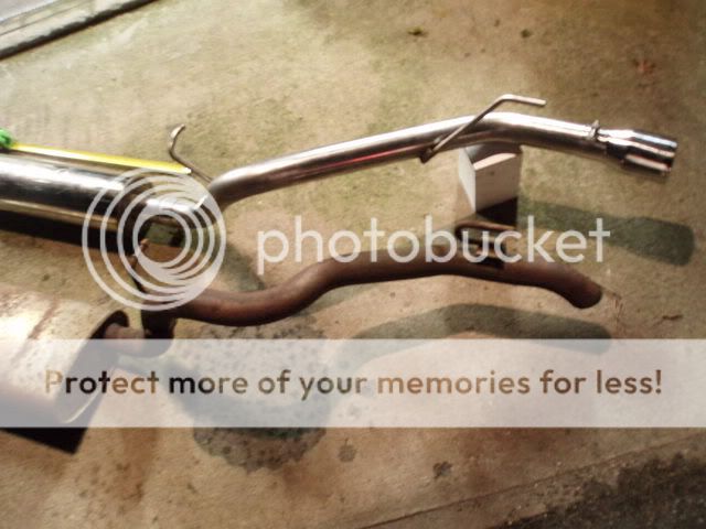

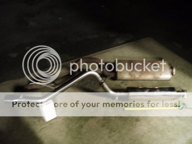

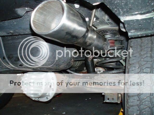

Here are some pics of the exhaust:
Whole album here:
http://s336.photobucket.com/albums/n355/ciberbosco/MBRP%20Exhaust/

PostPosted: Mon Aug 18, 2008 1:10 pm
Posts: 2019
How is your trailer wire harness run?
How short is the pipe with out the tip on it?
What does it sound like at 3200-3500 rpms?
PostPosted: Mon Aug 18, 2008 2:39 pm
Posts: 177
The Jeep came with the tow package so the hitch and harness were installed from the factory so I really have not payed much attention to how it was run.
As per the length of the tailpipe, minus the tip, I never measured that but could if you would like that measurement. With the tip installed, it definitely doesn't stick out past the bumper. Let me know which measurement you would like (ie. rear hanger to exit, rear of coil spring to exit, distance to bumber, etc).
Soundwise, there is very little engine noise volume or tone difference between stock and MBRP. If anything the MBRP is a tad more throaty and about the same volume as stock. There is, however, a slight but noticeable whooshing sound made by the exhaust gasses flowing more freely out of the exhaust at higher RPMs.

PostPosted: Tue Aug 19, 2008 1:14 am
Posts: 2019
I was just wondering if the tip is required to get past the bumper. Not a big fan of polished tips.
No in the photo I noticed that you still have what looks to be the factory body plug in the photo. The green ring behind the exaust pipe with no cable coming through.
Normally I drive between 3000-3500 rpm in the Jeep and I am worried about droning in the cabin. It is cool in the racecar when I have earplugs in but not in the Jeep.
You could always use high temperature brake caliper paint and paint the tip. Otherwise you could buy a different tip for $20 or so and sell the polished one on ebay or something.
At over 3000 RPMs, there is only a slight rumble from the CRD, definitely no audible drone though.
