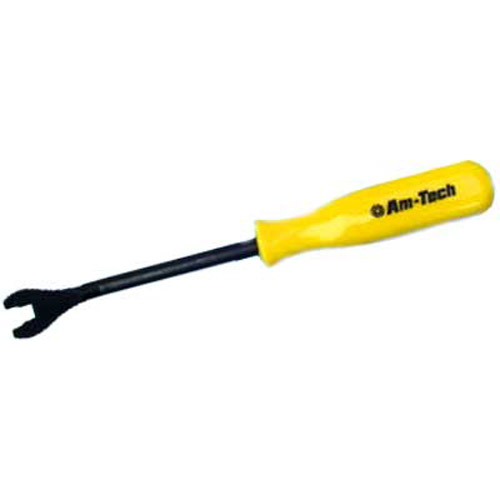

PostPosted: Sun Aug 24, 2008 5:40 pm
KeighJeigh wrote:
Uncle!!
So, I've broken pieces of the shroud trying to get it off (how the HELL do you get those stupid little push pins out without simply tearing at them with a screwdriver or pliers?!?!).
Thus far I've failed to remove the fan clutch. I've unbolted the fan. I still can't see any way of taking off the viscous clutch without some special tool #XYZ special ordered from Tasmania.
I DO (barely) see the small coil thermostat in the front of of the clutch but I can't tell if there is an adjustment on it for engagement temperature.
I'm very ticked off and flailing around at this point just unbolting and tearing at things..... But I have a lot of driving to do to suppliers this week and MUST have this thing up and running and the problem figured out.
So, here I am a week later, hundreds of dollars and dozens of hours into it, it's starting to rain, the car is now undriveable again and still no fix for the problem I have been trying solve. But hey! At least I'm breaking even MORE parts trying to get at suspected broken parts so that's a plus....at least for Chrysler parts salesmen. I'm tenacious but at what point do I simply get rid of these blasted rigs?
Those plastic push pins are easily removed with a tool that is in the pic below..............
As far as getting the clutch fan off you will need a special tool for that,again in the pics below..............
The fan holder.....
And the wrench,there are many sizes and I am not sure of the CRD's correct size...............
Or you can get this set from MatCo tools that you use with a air hammer,very nice tool kit.
Working on modern vehicles require special tools for everything,nothing sucks more as a technician and having to dishout $200 for a special tool and only ever need it for one job :evil: .At least those air hammer clutch fan tool kit can be used on almost every newer vehicle.
