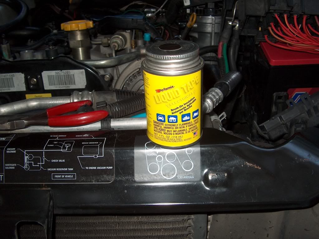

You'll need to remove one of the pipe plugs at the front of the intake manifold to get to Boost pressures which can be up to 20psi at full Boost, or drilled and tapped, as seen here to the left rear of the Liquid Tape can lid, that brass fitting with the clear nylon tubing

I see. I thought about drilling. How do you keep any of the metal from getting into the manifold or doesn't that matter?
I can see several "pipe plugs" they have threads down the center and do not have any caps on them. There is one close to where you drilled and taped.
How do you prevent any metal shavings from getting into the manifold?
All I see are threaded pipes without anything covering the threads or holes. I hope there is not supposed to be a plug in the threads. I see the same in your photos.

Those are all metric-tapped accessory\bracket mounting stand-offs - this engine is used all over the world in marine, stationary, commercial vehicle, etc configurations - I tapped that stand-off for 1/8"npt, blew that chaff out with shop air, then drilled a 1/8"dia hole thru into the intake plenum using shop air to clear the hole as I drilled - not enuff aluminum chips left when the drill worked thru to worry about, at only 1/8"dia
EDIT EDIT EDIT: my bad - there are no threaded plugs, only welch plugs - drill'n'tap is the method of choice..............

If I use a shop vacuum with a narrow end it would pick up the shavings as I drill. When you say drill and tap, ...would it be better to "tap" the existing threads on the stand off and then drill. Or will the stand off hold the brass vacuum fixture by just screwing it in tight...the threads are cone shaped in appearance..not straight down. (I may have just answered my own question.....nope, have to tap....

Vacuum cleaner is prolly ok, tho you can plug the hose into the vac outlet port for pressurized air - just tap the existing metric threads, then use a 1/8"dia bit to drill thru into the manifold plenum - the hole was pre-drilled and tapped, so the previous bit-point angle at the bottom of the hole should center the smaller bit - hold the drill-motor as vertical as possible, don't hold your breath, and the deed is done.......................
