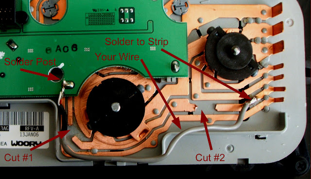

yeah I noticed that too, very lame. wish there was an easier fix to stop the ac compressor from coming on in floor mode.
having the heat blowing in your face drying out your eyes isn't really that good.

 Post subject: Re: Removing the Viscous Heater, Anyone Done It?
PostPosted: Fri Nov 05, 2010 5:24 pm
Posts: 2122
Location: Fort Collins, CO
There is a way to disable it. I've done it on mine.
http://jeepkj.com/forums/viewtopic.php?t=1265 but the board is down right now.
You can either cut the trace that activates AC or put tape there so contact can't be made with it by the rotary switch. I used tape. Easy fix.

def going to take out the heater till next winter at least - and can't wait for the other board to come up to get going with my tape :POPCORN:
*Edit* just seen the time stamp on this thread - can someone get the info for the "tape A/C fix" as the KJ site doesn't look like it is coming up anytime soon

Hey Flash
Sorry - you going to have to go slower for us noobs.
Is that pic from the back of the controls on the dash?
where do you put the tape?
thnx
Edit - Found it
http://www.jeepkj.com/forum/showthread.php?t=26491
