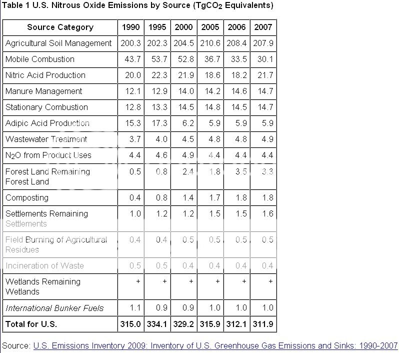

I suspect that GDE did what they did to keep the Acid Head Hippie induced legislation off their back, by not totally shutting off the EGR. To cover their backside and bank account they can not endorse the plate or other devices. Other tuners will not touch the EGR part of the tune. Anyone who states that any legal tune shuts off the EGR is blowing smoke and not out their CRD tail pipe.
In my opinion most of the Acid Head Hippie induced legislation is as stupid as making it a law that requires a bride not to wear black panties under a white wedding dress.
To be honest from a performance stand point, I would put up with DEF (Urea) instead of EGR given the option.
If you make the assumption that CARB did not contaminate the following EPA chart with any of their bogus DATA. Agricultural Soil Maintenance produces 6.9 times more NOX than all mobile transportation combined that includes Diesel Engines. Even in Silicone Valley, it looks like the grass will produce more NOX than the cars and trucks do. When I was there the indoor air pollution from perfumes and cleaners was greater than the outdoor pollution coming from mobile transportation. With asthma, cockroach droppings cause more attacks than diesel engines, even the older ones.
Just making some jabs at Junk Science :P :P :P :P
