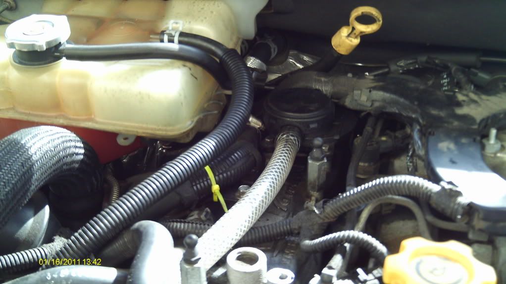

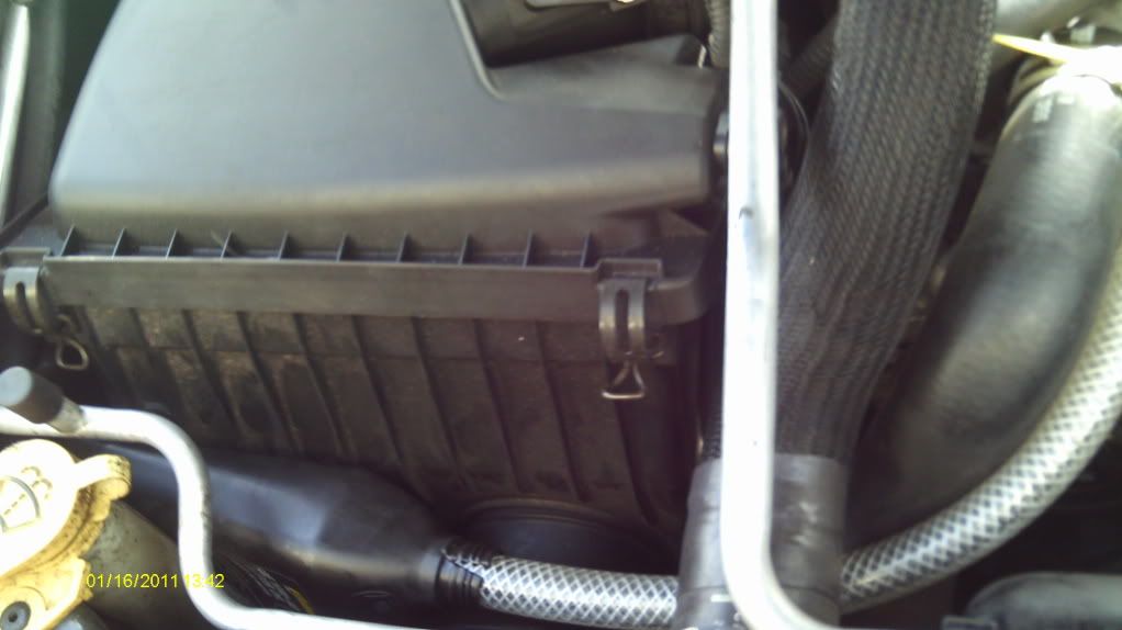

Finally got a chance to get some things done today. I pulled the MAP sensor and cleaned it off, it was caked so bad you couldn't even tell there were holes in it. I also did my own version of the elephant hose mod. I had a short piece of hose laying around from a fish tank, and it was just enough to reach the air box. I slipped it on the manifold, and put the other end in an oil quart.(empty of course) I had to poke some holes in the top of the quart to let the pressure out, but now I at least have a catch can. I shoved a rag in on top of it just in case some oil decides to try and get out the holes.
I'll be doing it better later on, but for now this will have to do. I still have emissions BS to deal with, so I don't wanna get to far into the mods necessary to eliminate all the stuff that never should have been put on the engine in the first place.
Oh yea, I also fixed my trans dip stick, it wont be popping out any time soon! I just took a pair of pliers and slightly bent the edge in a bit, now it fits tight and won't come out unless I pull it out. :mrgreen:
