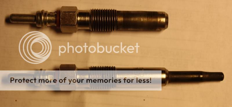

MOSFET wrote:
It was my understanding that the new glow plug controller outputs the correct voltage for the new glow plugs, but I am not 100% sure of that.
Thats what I a wondering..
Think I will screw up anything if I disconnect the plug harness and install the new relay/control and test for voltage? has anyone done this yet?
here are the new plugs...

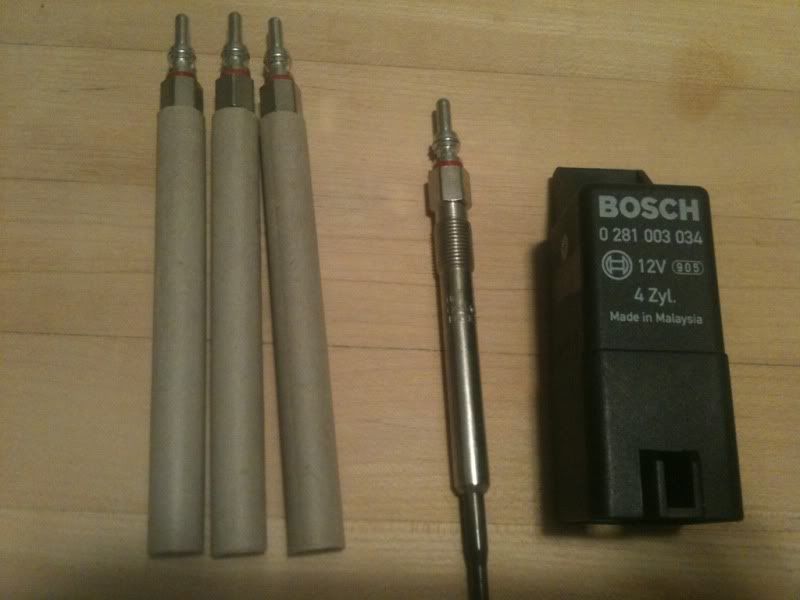

The glow plugs look to be different for sure and with the lower voltage the flash will need to be updated.
But the Bosch part number 0 281 003 034 for the glow plug controller is the same on mine an '06 and at least two others with '05s I have contacted.
In my humble opinion, selling a new controller with the same part number and calling it a new design is a scam, unless painemann just happened to get sold the original glow plug controller instead of the, "NEW ONE".
So is the new glow plug controller with the exact same part number a:
1) Scam?
2) Dealer/Mopar error?
Can't be both.
1) Scam?
Can't be both.
Well I hope it's not a scam, it came in the same box as the plugs. And it came right from a jeep dealer, picked up in person. It is also the part number listed for the "kit". I know someone else posted they had the kit, maybe he can comment.

Looks like a Mopar Scam to me, why replace the Glow Plug Controller with the exact same part number that has been used for 6 years in the US/Canada and call it new. Mopar duped you when all you need is the Glow Plugs and their phantom flash that they have not yet released. Since you are committed, you are better off trusting your tuner who has a better clue than the Dealer.
Oh BTW, I saw a failed TDI glow plug from the same vendor that makes the new CRD Glow Plugs trash out a VW PD TDI engine posted on a VW forum.
Looks like they failed to roll crimp the heating element in place properly, so it fell out and trashed his engine. Check yours very carefully before you install them, make sure they did not skip the final step of production, should be as obvious as the diffrence between the two glow plugs.

With all due respect, why would the same Bosch number not be the same GPC?
Chrysler stamping their number on the side of the GPC would not make it magically change what is inside to make it work.
Doesn't the ECM Chrysler wants to flash control the pulse width and time to enable the 5V glow plugs to run on 12V and not the GPC? What else is Chrysler going to change or EF up when they do a flash?
If Bosch called it a 0 201 003 034 A instead, there Chrysler would have some creditability. The way I see it,Chrysler has none at this point.
Right now I have less faith in Chrysler having a New GPC with the same Bosch part number as the old one, than I do in the emails I get where they sell blue breath mints for $2 each that claim to be generic Viagra.

The CY part number isn't stamped on by Chrysler, it's done by the supplier. Chrysler also doesn't "assemble" the kit, that's done by who supplies the kit to Chrysler.
I need to check into this...
The ECU sends a PWM signal to the GCU, the GCU then converts this into the voltage going to the glow plugs. The difference of the GCU is in the internal circuitry, but the functionality is the same.
