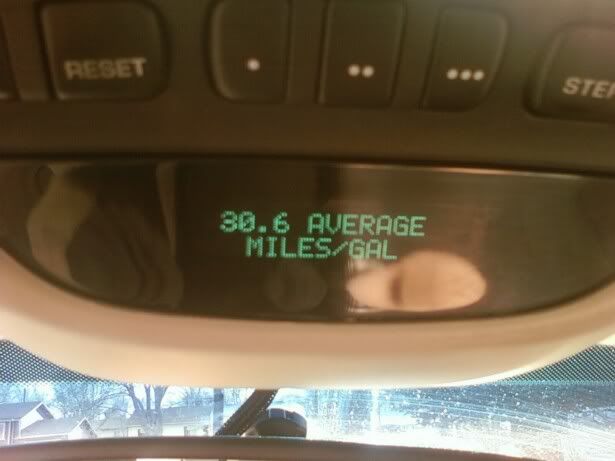

 Post subject: Re: honest fuel mileage
PostPosted: Sat Jan 22, 2011 11:09 pm
Joined: Sat Dec 18, 2010 3:38 pm
Posts: 156
Stock with the MAF unplugged, doesn't get much more honest then a pic.
Actually, it does. The EVIC, even on stock CRDs, is often 3-4mpg high. You need to measure how much fuel you put in against how many GPS miles you've driven.
225/75R16 Hankook Dynapros
PostPosted: Sun Jan 23, 2011 12:41 pm
Posts: 156
I do, and as soon as this tank is gone I'll come back with my actual numbers. I was pretty impressed with that though, driving a brick at 75 and getting 30MPG. It may be high, we'll see in a few days. I also should note that Im using premium diesel from chief petroleum. It's a bit more expensive, but much better then the "gas station" ULS!
PostPosted: Sun Jan 23, 2011 2:47 pm
Posts: 909
Location: Kearney, NE
Full stock, my guess is you are closer to 25-26 at that speed. It's been a long time since I had the stock ECM, but I believe the EVIC always had a tendency to keep climbing on prolonged highway trips.
Post-tune, I drove 450 miles nonstop once. Every 10 miles, the EVIC climbed 0.1mpg. By the end of the drive, it said I was getting something around 44mpg! The tune exaggerated the issue, but I vaguely recall something similar occurring before.
