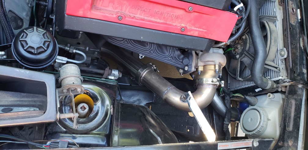

I think you might be overestimating the deleterious effects of a cat. I have three nicely tuned turbocharged cars. On the last dyno pass, the XR4Ti made 320hp without a car, and 308hp with a cat. 3% loss on a 3" Magnaflow. Not even worth worrying about.
Somewhat related, you do NOT want a vacuum behind a turbo, certainly not a factory turbo. "Negative backpressure" is particularly bad for journal bearings. IME, you're 100% better served with a sizeable downpipe to handle post-turbo exhaust expansion (and create a big volume+pressure differential) than by removing the cat. Removing the cat from a modern car does little to nothing.
That was good for 33hp on 20psi.
Removing the cat (another 3" Magnaflow…) netted 8.

Anything you can do to lower backpressure on the exhaust side of the turbo i.e. larger exhaust, removal of the CAT, straight through muffler, etc... helps improve turbo response time and lowers EGT's leaving the combustion chamber. All proven facts. I have actually proved this myself on my Dodge Cummins since it has an EGT gauge. I don't make this stuff up, plenty of information and reading online about the effects of lowering turbo back pressure with free flowing exhaust systems, removal of CAT, etc....
But if you like your CAT's, keep them, it's your vehicle, as for me, don't like them.
