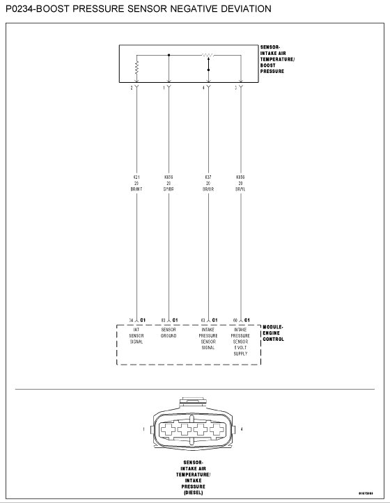

It wouldn't hurt to test the MAP sensor. I tested mine by taking it out of the vehicle and hooking a 6volt battery to the appropriate terminals on the sensor. I believe 2 - 4.7 volts is a high boost reading for the sensor. Mine tested at 2 volts sitting at the dining room table. For the longest time my sensor was saying there was more boost there than there actually was and causing more fuel to be injected than necessary. I gained 2 mpg when I replaced my sensor. I must have damaged mine when cleaning a while ago...
Can you give test procedure and possibly pics? this may be a problem for lots of us getting poor mileage. Did you have any fault codes (CEL) that led you in this direction? :?: :!: :?:
When the intake manifold pressure is low sensor voltage output is 0.25-1.8 volts at the ECM. When the intake manifold pressure is high due to turbo boost, sensor voltage output is 2.0-4.7 volts . The sensor receives a 5-volts reference from the ECM. Sensor ground is also provides by the ECM. The ECM uses boost pressure combined with intake air temperature to determine the volume of air entering the engine.
Let me know if this helps at all...

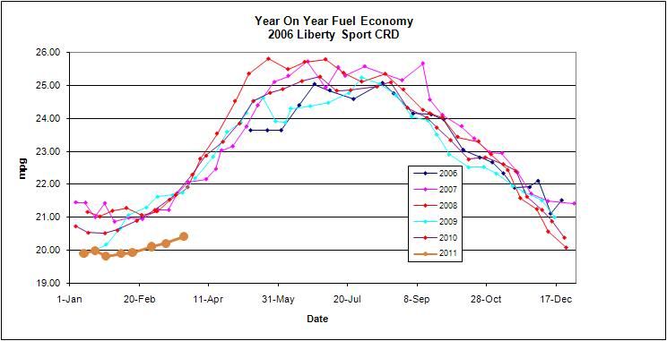

Here is my data for the last five years (since new). 20-21mpg is typical for this time of year but don't forget to correct for odometer error (5.26% in my case) which, if you haven't done this, would bring your 19-20mpg in line with mine. My circumstances are also almost the same, 50 mile round trip highway @ 75mph but a bit colder up here.
Now, as for this year something unusual is going on. I've dropped about 1.5mpg since January. My average temperature may be a bit in the low side but more noticeable is the variation as it tends to drop more than I recall during previous winters when idling.
Fantastic Post Dirtmover. The only time I had a consistent loss like you posted was when my t-stat died :dead:
