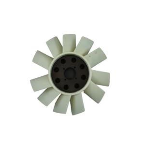

I'm thinking about swapping out the fan when I upgrade to the Hayden clutch, but the photos I'm seeing for part number 52079654AD (supposedly the nylon fan) vary greatly from...
a white nylon fan (only)
..to a black plastic fan encased in housing with cables.
Going from just these two choice, I assume I'm looking for the top (white) model, but I want to be sure.
Anybody done this mod? Which fan should I actually be purchasing?
Yup, top one. Just had one put on mine Friday with the Hayden 2905 during timing belt job. It is surprisingly light compared to the metal one.
Whoa, Horsey!
You need to realize that the second fan you posted, the "black plastic fan in a housing with cables" is ALREADY PRESENT. Your CRD has two fans, and this second one is an electric fan mounted IN FRONT of the radiator. It comes on primarily to cool the transmission cooler and air conditioner condenser. It is NOT in any way a replacement for the mechanical fan that is the white plastic fan in your post.

naturist wrote:
Whoa, Horsey!
Yep. But they come up as the same number. That's why I was saying "I'm pretty sure it's the white one," but pointing out the weirdness in case someone else does a search when purchasing parts while loading up for the Timing Belt (et al) change.

I have swapped the stock 5 blade metal fan on my 2005 2.8 CRD KJ to the 11 blade plastic one off the 3.7 V6, but I used the CRD fan clutch on it.
It blows more air than the metal one, even at tick over, yet it seems quieter, especially in the cabin.
With the CRD clutch on it, it is 500g (1.1lbs) lighter than the stock metal fan.
The only downside I have discovered is higher fuel consumption with the plastic fan vs the metal one...Almost certainly as a direct result of it being able to blow more air...To do this it has to absorb more power from the engine, and therefore you end up using more fuel. I have noticed my average fuel consumption drop from between 32-34mpg to 26-28mpg...A significant increase...So much so I am now considering either modifying the fan, say by removing 5 of the blades and leaving 6 blades, and then rebalancing it, or simply going back to the stock metal fan.
Here is what the 11 blade would look like as a 6 blade:
