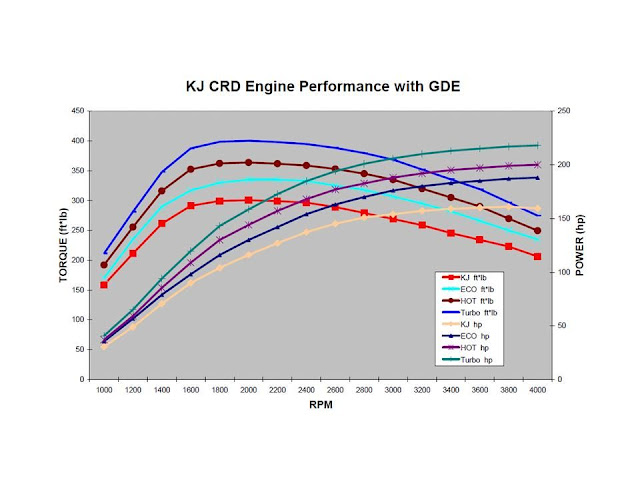

I don't understand the 270lb/ft of torque limit with eco tune. The stock torque numbers are 295lb/ft. I thought the eco produced slightly more like 315lb/ft. why wouldn't the tranny be capable of using this power.
The f-37 de-tunes the engine to put out less torque, and changed the shift points all to save the TC from destruction. The normal eco-tune goes to 270 ft/lb for the same reason, so if you have a healthy enough TC get the full torque ECO tune (or Hot Tune :twisted: )
From GDE's site showing Full Torque Eco tune:

I don't have the F37 mod as none of my shift points are above 57MPH. My question is where in the chart does it show that the torque has been reduced from the original CRD by using one of the GDE tunes. All of the torque and HP numbers are increased from the original CRD numbers.

That graph doesn't show the standard ECO-tune torque, they did have a table on the website but I am not sure if it is there as it won't display on my current computer. See if this works: http://www.greendieselengineering.com/forum/posts/list/20.page
301 ft/lb max stock pre-f37, 335 with the ECO-FULL TORQUE tune, so not a huge jump for you

It appears that mine still has the pre-F37 settings (first & second columns) and probably no F31 after talking with Keith. This means my torque output is greater than the locked 260lb/ft. I had no shutter and the Liberty pulled hills towing with no problems. The next question is FT ECO or standard ECO.
