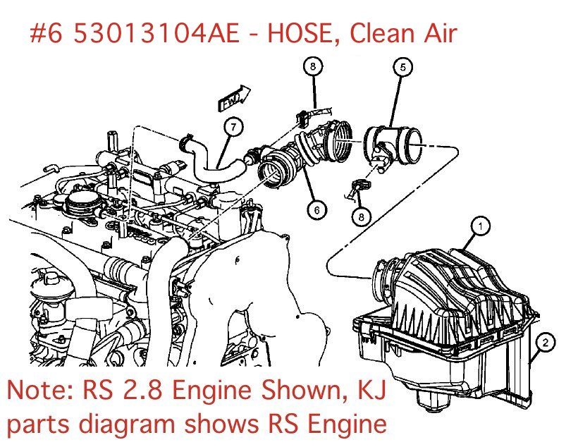

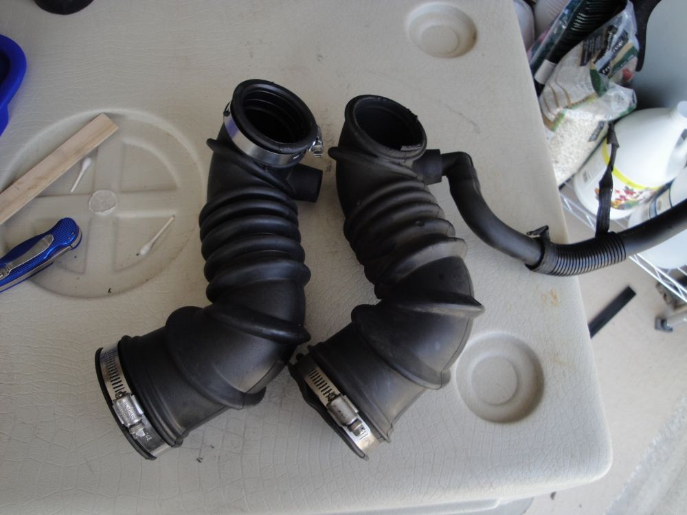

I just order this part last night. The hose is from the air box to the turbo. I don't know if mine bad yet. I can tell the oil has got to it and looks old. I read post were its cause problems. U might look at it. I would think if that hose was broke it would be loud turbo noise. U might ask around on this one. We are going to take a long trip. So I'm replacing anything that might cause problems. I also believe u can check for turbo shaft play when u replace that hose. Hope this helps.
Mopar Part 53013104AE CLEAN AIR HOSE
