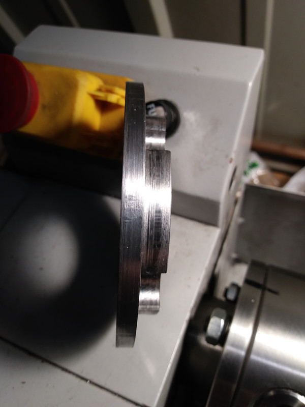

I replaced my damper with a new one for a Duramax 2.8L. It is not a direct bolt on. I made a steel adapter to allow the Duramax damper to bolt on to the 2.8L CRD crank. It has been working great and if the rubber ever dies, I can just buy another from the Chevy dealer being they are supporting that engine. It looks factory and uses the stock belt and no other changes needed. It had been on there for about two years now and was around $70 bucks for a brand new one.

Got any drawings of the adaptor you can share?

It's a machined plate just under 1/2" thick. I have pictures of it from start to finish, just have to find them and post them. I made it on a 8"X16" lathe and a mill, it is actually quite a simple piece, just very precisely made, picture a small version of a wheel adapter. I knew the 2.8 Duramax was just the newer version of our 2.8L CRDs and took a chance and ordered in a balancer, timing belt sprocket and new damper bolts for the Duramax 2.8L. You can't use the timing belt sprocket for the Duramax, they changed the width of the timing belt, and if I remember right, won't fit on the crankshaft snout, it's too loose, so you use the original timing belt sprocket for our 2.8 CRD. The bolt circles on the dampers are also different diameters, which actually works great for making the adapter work. The outer diameter where the belt rides is the same so it uses the factory serpentine belt and nothing has to be changed to use it.

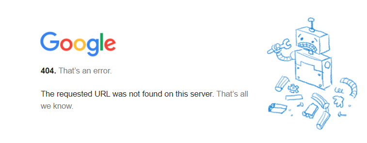

Unfortunately, none of your links work! :cry:
All three links you posted gave the same error. Google says it's not found!

Front View of Harmonic Balancer Adaptor to use Duramax 2.8 Balancer (Provided by "Rattlin' KJ")

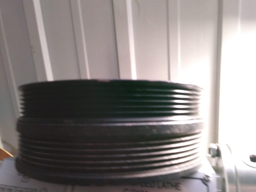

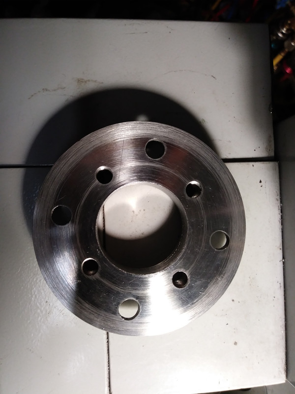

Okay, thanks to WWDiesel, I can now actually post the pictures of the adapter.
Back view:
Side view:
Front view:

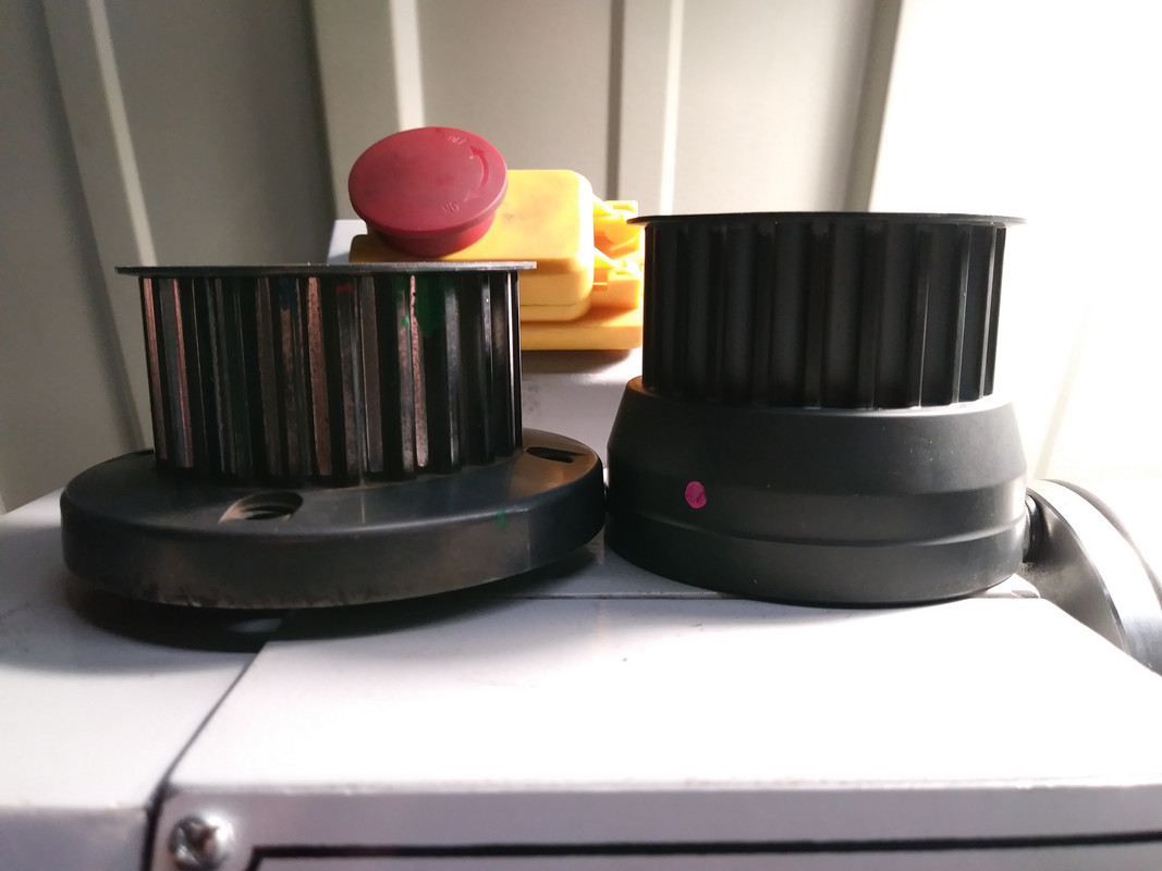

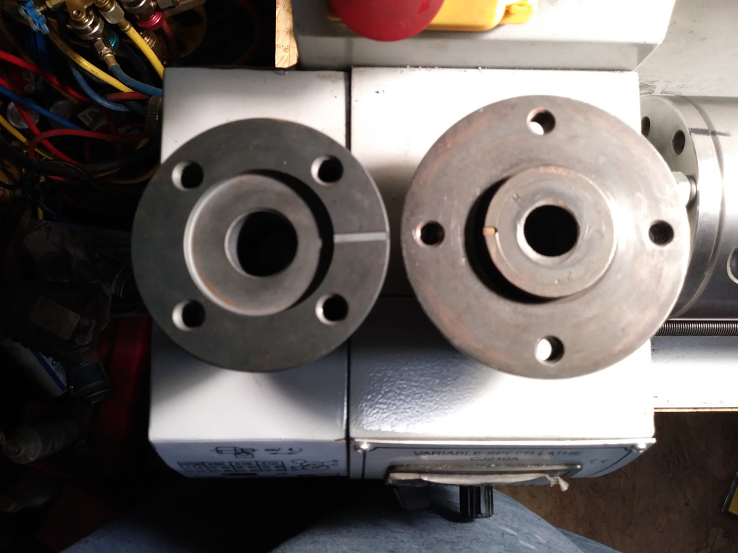

The Duramax 2.8L timing belt sprocket is on the left, our 2.8L CRD timing belt sprocket is on the right, notice the difference of the bolt circles. Also notice the center of the 2.8L CRD timing belt sprocket on the right, this bump out is what centers the damper. The Duramax 2.8L damper centers itself around the outside of the Duramax 2.8L timing belt sprocket. The centering of the damper at these two points with the adapter is crucial to make sure there is no runout and therefore no wobble.
Our 2.8L CRD timing belt sprocket is on the left this time, the Duramax 2.8L timing belt sprocket is on the right.
The Duramax 2.8L damper is on top of our 2.8L CRD damper in this pic.

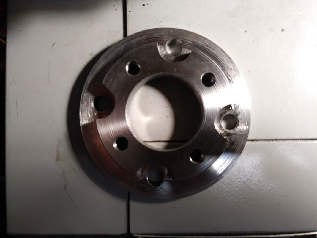

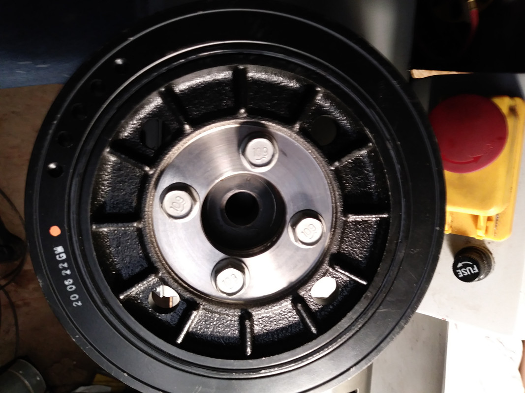

PostPosted: Sun Jul 16, 2023 10:32 pm
Joined: Thu Sep 10, 2020 9:38 pm
Posts: 10

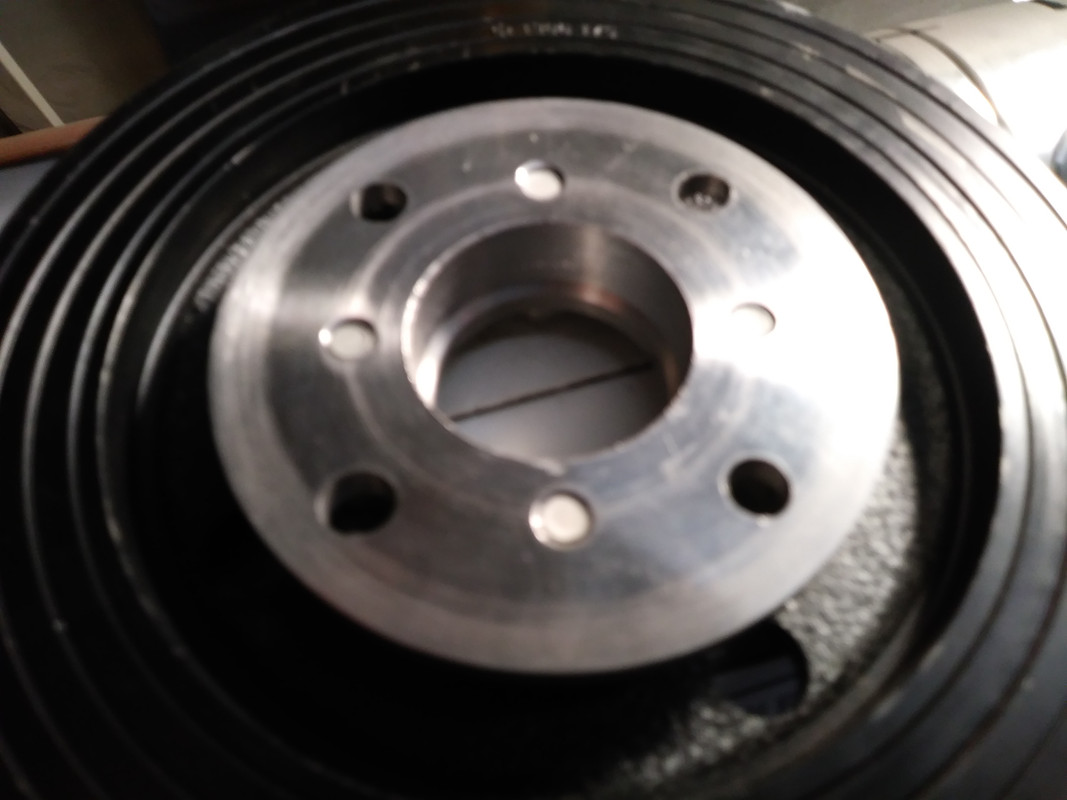

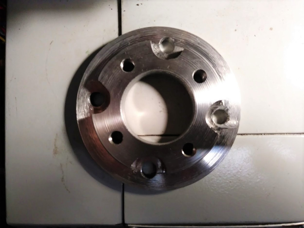

This is a pic of my adapter mounted to our 2.8L CRD timing belt sprocket.
This is a pic of my adapter mounted to the new Duramax 2.8L damper, notice the new Duramax 2.8L mounting bolts do not stick thru the adapter and interfere with the fit.
This is a front pic of the new Duramax 2.8L damper bolted to my adapter.
I made this adapter in December of 2020 when I replaced the timing belt, water pump, etc. The damper runs true and uses the factory serpentine belt with no other changes needed.
