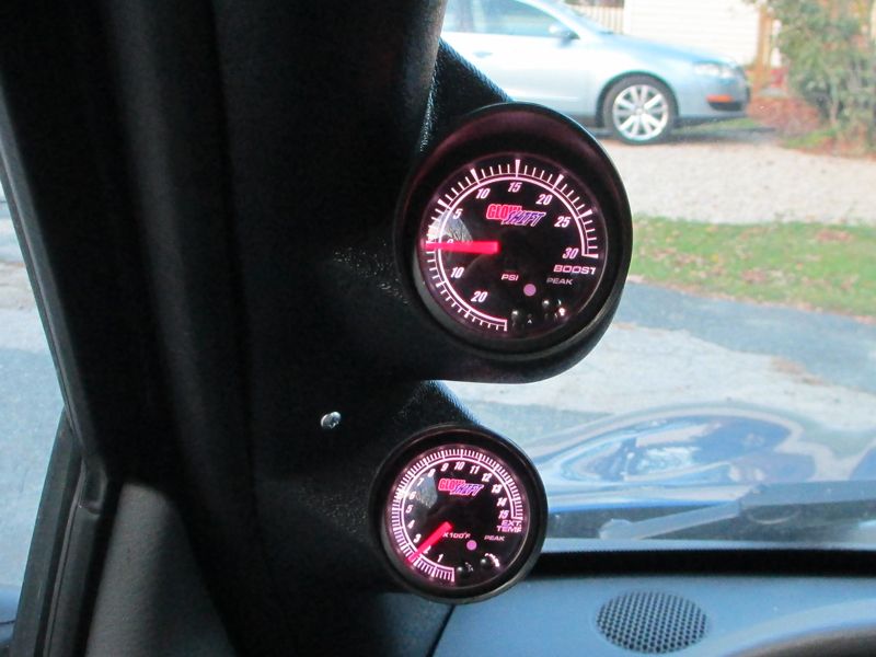

Freshly installed Glowshifts. I had a little issue securing the gauge pod. Anyone else have issues securing it? The screws that came with it was useless.

Really like the Glowshifts were did you get them. Pictures look great
www.glowshiftdirect.com and the pod from JBA, but he had it drop shipped from gaugepods.com. I am not all that impressed with the gauge pod. But, our Liberties are limited to what we can get.

There are no gauge pods made for the 06 Liberties :furious:
Something was changed on the pillar and so the available pods are for 02 through 05.
But you were able to make it fit so so now you know the difference.
