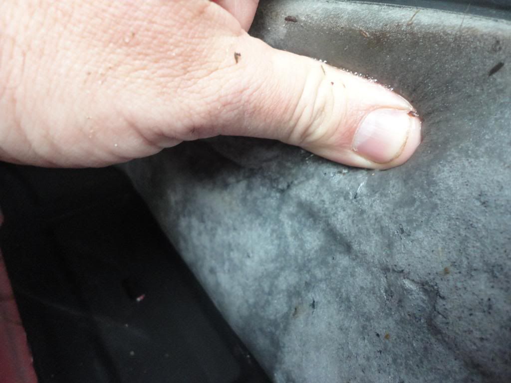

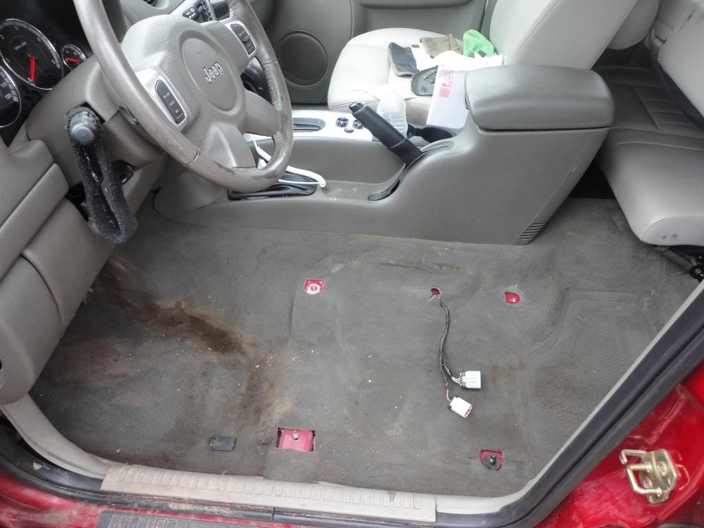

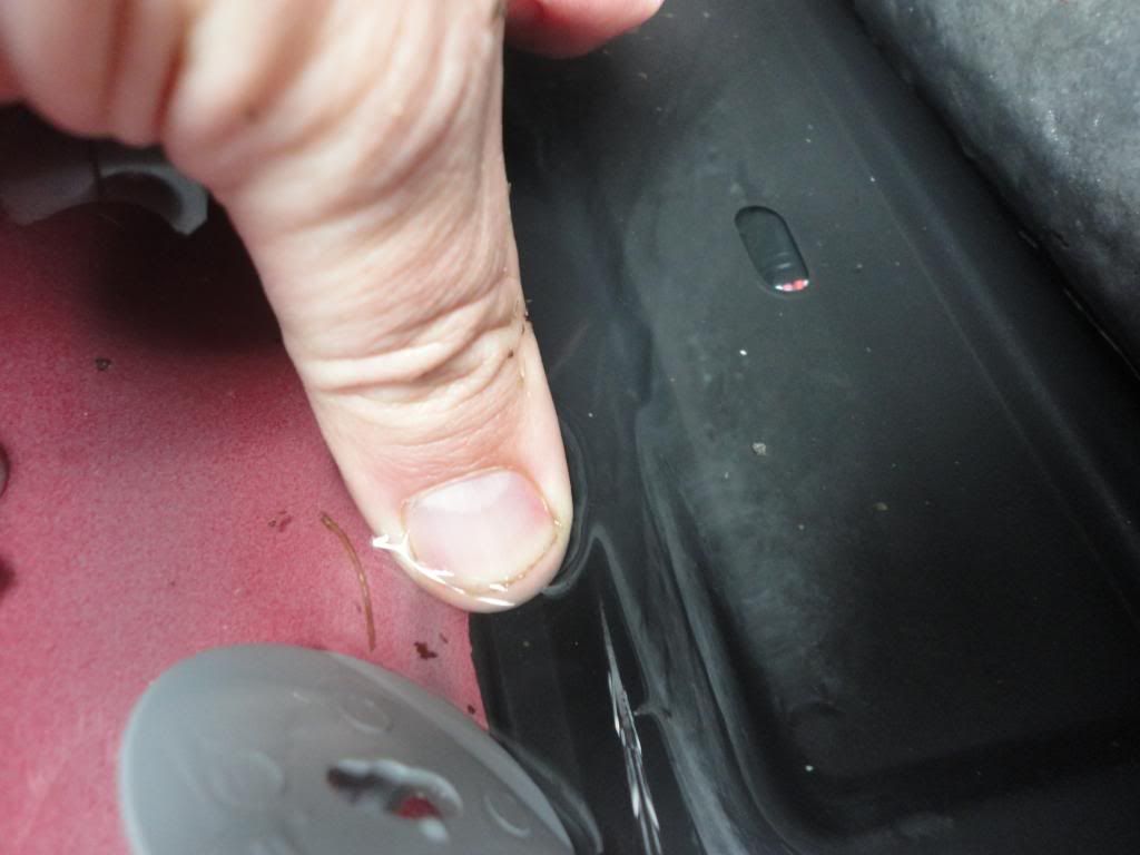

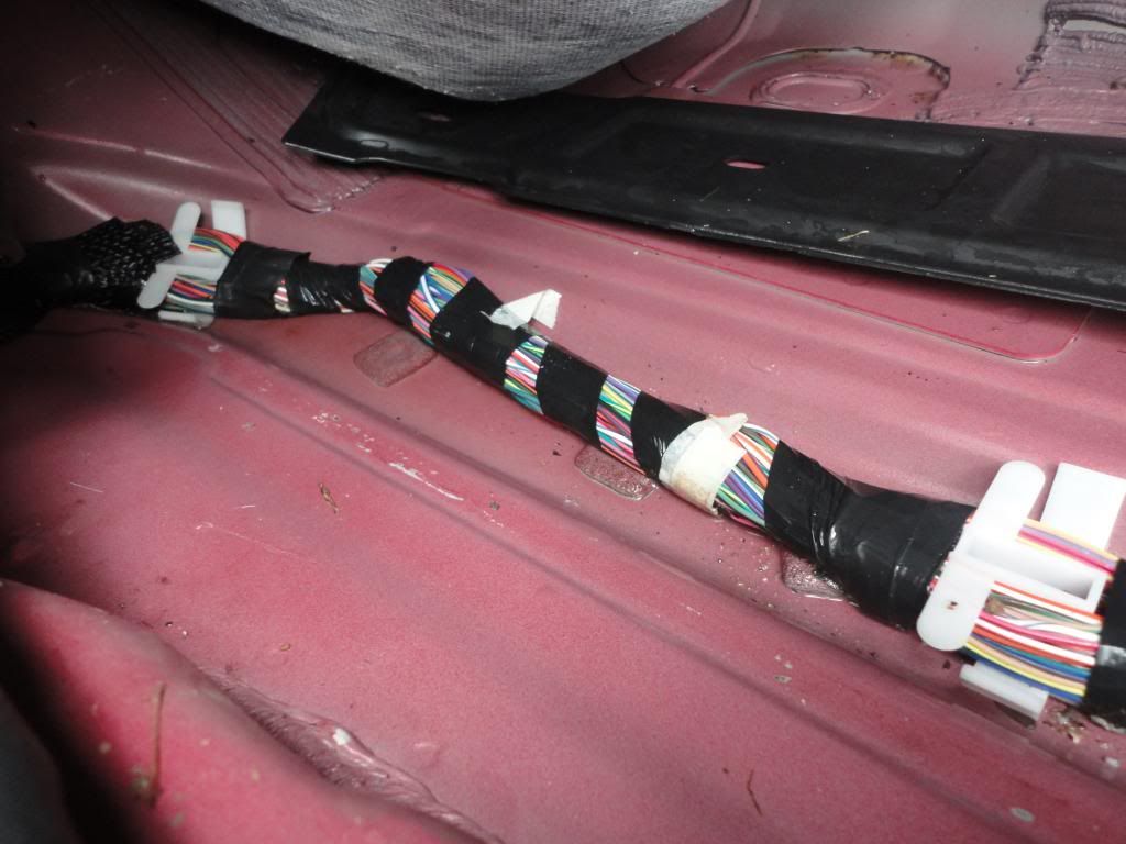

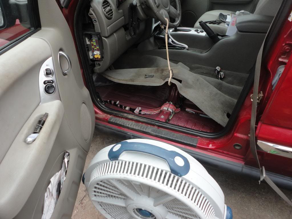

Got the new battery (Platinum P1) in and replaced the horn fuse. It has been silent for about 25 minutes now. Hopefully the issue is solved. Now to find out where the water came from. On to the pictures:
The Jeep with the seat pulled:
The matting under the carpet. I could gently squeeze it and water would run out:
The depth of the water under the matting in the channel where the wiring runs:
That whole channel had water in it:
The carpet hanging and drying with a fan:
Tomorrow I'm going to close the Jeep up and start running water along the door, windshield, and sunroof to see if I can get any water to go in. I'm also going to check the sunroof drain line to make sure it's clear and then go from there. Thanks again for the help and suggestions.

For what it's worth that looks exactly like what I experienced with a minor sunroof leak which by the way has not resurfaced.
