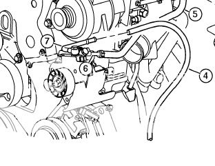

Location: Malpas, UK
Wondering if the washers on the inlet banjo onto the fuel pump are leaking when it gets hot? Steel pipe #7 here, rubber hose is secure onto it.

Steve from that photo:
the front port on these filters is the inlet
the side port is the outlet.
The two side ports are the outlets.
Just something to verify.
I'm clutching at anything you might gain from to try to help.

They are the correct way around, its just the routing of the glass filter pipe makes it look wrong, the glass filter is on the inlet feed.
