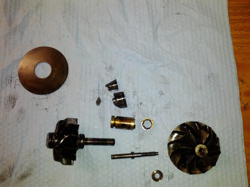

Used turbo and Mishimoto hoses installed, fogged neighborhood for mosquitoes, all is good now :) Had to drive the CRD up I70 into the mountains to burn all of the oil and crap out of the exhaust. I've never seen so much smoke come out of an exhaust before! The failure appears to be from carbon deposits on the oil seal, causing it to seize in the bearing and break the casting inside of the turbocharger that supports the bearing. Either that or the casting failed then then it snapped the turbine shaft. Above the bearing, you can see broken pieces of the turbo casting I was able to fish out of the inside of the cartridge.

Really sounds like turbo to me, with the metal being either pieces of the turbo bushing, or housing from the stuck piston ring seal on the turbine. Reason he didn't see any metal is because it settled from sitting. Did he drain the pan to check?
Yep. Glad you got it sorted out, and thanks for the pic/update
