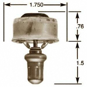

If money is tight and you need a $10 band-aid option, see the link below. Install into the upper radiator hose with the "bulb" facing the engine as close to the inlet as possible. Then calculate your MPG over the course of a full tank of fuel and see how it compares.
Stant 13519 Thermostat - 195 Degrees Fahrenheit

That $10 band aid could cost an $1800 head. :dead:
Just buy the TDF tstat and let me know how it works out, or get the OE and save yourself the pain of a warped head.

yeah, if you do use the band aid, make sure you drill a tiny (about 1/16 should do) hole in it if possible (not sure with that style as I have the big clam shell inline in mine that houses a regular stat), as that will help with hot spots, but you could get unlucky...
After you drill the hole and mount it in the radiator hose, be sure that the hole is in the 12 o clock position. This is better for allowing air bubbles to pass through.
And if you are really paranoid about it, drill two holes. One at 12 and one at 6 o clock.
I too use the Meziere in line thermostst housing because it uses a very common chevy 350 thermostat.
Just be aware that not all thermostats are created equal. Given any 195 deg F thermostat, some will open at 190, some at 200. Plus or minus 5 deg is normal, unfortunately.
