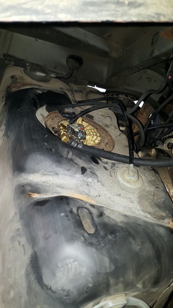

Tell me about it. My windy posts on the Kennedy install thread are suddenly very deflated! I may contact the supplier and whine; less than 3k and out? Seriously?
UPDATE: Kennedy is fine, but it's not self-priming, #@$& !. PO'd that I chose it. DON'T install a non-priming lift-pump!
I'm so use to (F250/350, etc) pita tank-drops that I bias towards external pumps, but in reality these KJ tanks are very accessible compared to most. I'm not certain that's a good thing in terms of impact safety, but you can't complain about working on and around them.
Time to sew this back up. After four months it's going to be amusing puzzling all of the hoses/lines back in, but it'll probably be common sense. I took tons of pics during disassembly and then my previous cell promptly died before I backed them up.
Here's the on-tank fitting/installed to remedy any constriction/crimping that may have been occurring with the fuel-line "U" it replaced; if you look at the formed-contours on the top of the tank, those mate snugly into the frame gussets above, so I suspect that the previous looping fuel-line may have been getting squeezed:
Now, the replacement fitting & line are essentially retracing the OEM fuel-line routing. I used layered patches of gorilla tape to protect the tank from chafing where one of the brass 90's rubs a bit.

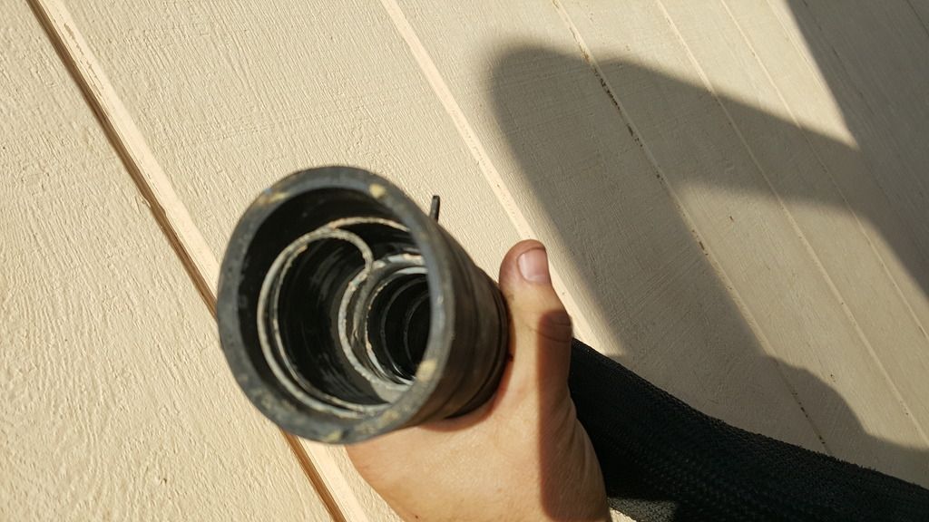

In the hope of completely eliminating the elevated coolant temps I was enduring during the Vegas summer, I had:
- Installed 11-blade fan & Hayden clutch
- Flushed and filled with CAT-spec NOAT coolant
Those measures only gave nominal improvement.
However, during this major surgery I have installed:
- New H2O pump
- Thermo

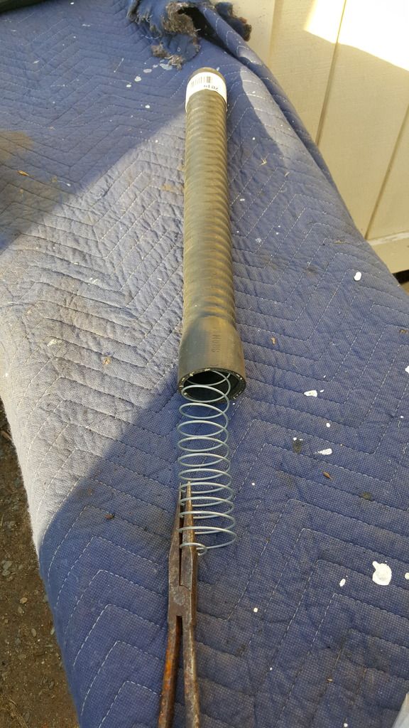

The only remaining suspect component was the lower radiator hose (radiator looks exc.), more specifically the turn at one end lacked an internal spring to resist collapse during coolant pressure variation.
Both rad hoses look otherwise fine; I have no idea if the OEM lower hose normally lacks a spring at one end, but I'm not interested in leaving it to chance. So:
OEM lower rad hose-end with spring;
Same hose, other end, no internal spring to my thumb:
New $5 shorty rad hose, unknown vehicle application, with corresponding segment of internal spring rotated-out:
Spring-segment clipped and transplanted into CRD-hose:
Maybe others have done this before, me no; I'm grateful to the Ensenada Azone staff for advising this solution.
I remain curious if that "empty" segment is CRD factory spec.
Now, this beast better #@%& maintain normal operating temps!

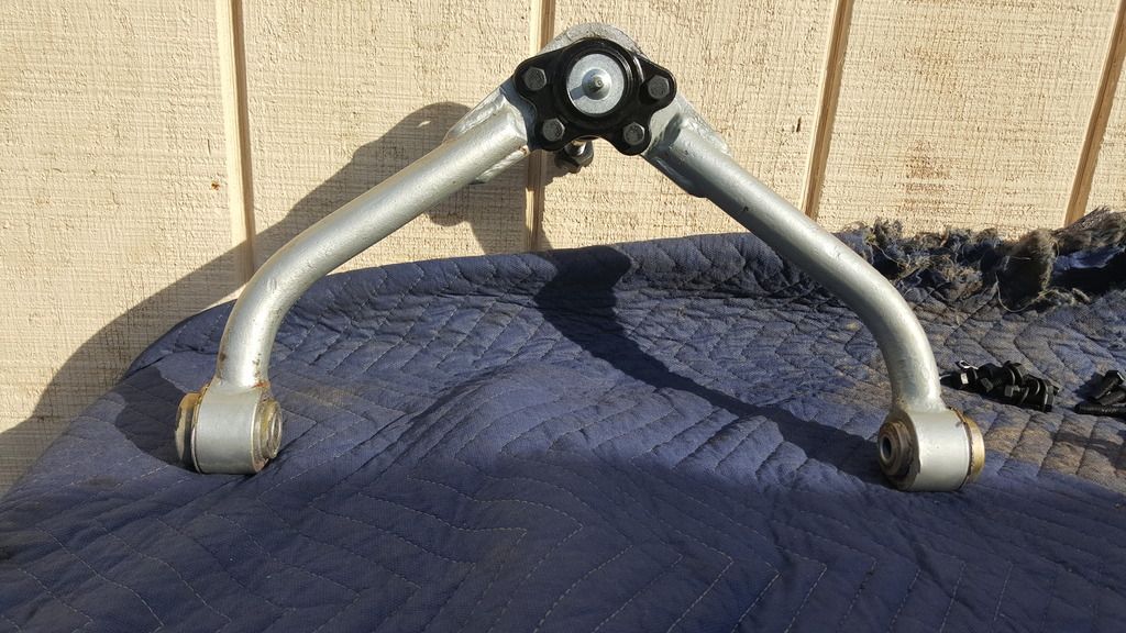

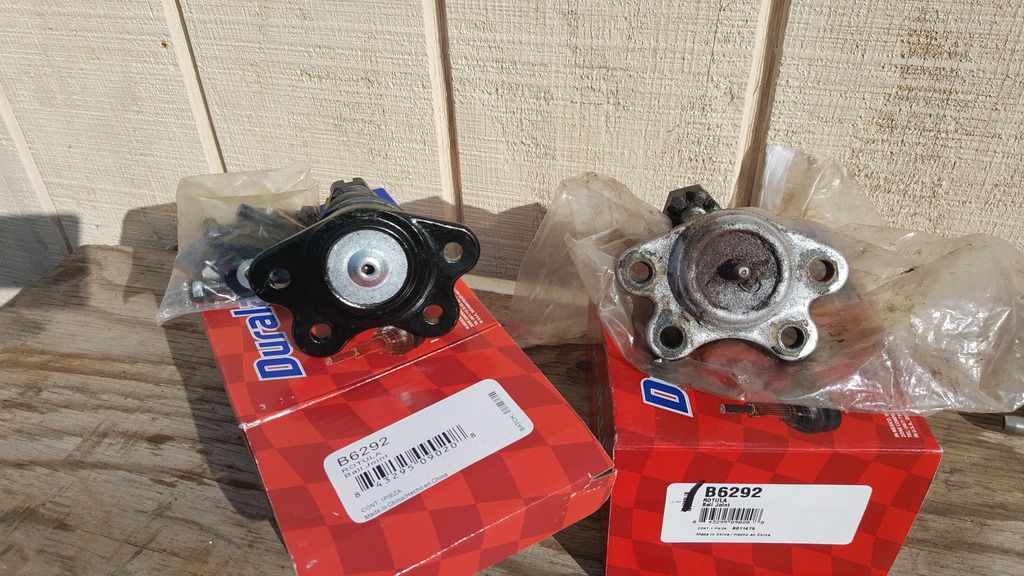

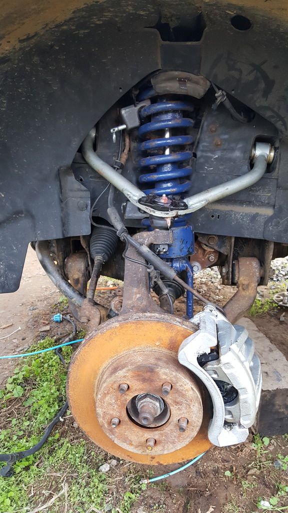

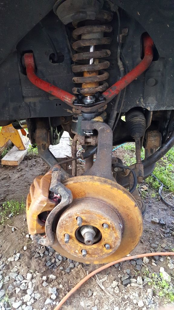

Another issue was that the left-side's JBA UCA bushings had been damaged during removal-from-hell (6-frozen lca/uca bolts, 24 hours labor). I never got a respone to my pertinent email inquiry from JBA, but now maybe I know why: they do, in fact, accept the OEM UCA bushings, Part #BCK96036 (@ azone).
Also, the JBA-compatible replacement upper ball-joint is spec for a '96 GMC 1500 Van, Part #B6292. This is clearly sub spicer-grade ($60 @ JBA) but for $16 seems adequate:
A local suspension shop's hydraulic press failed to coax-out the old JBA bushings, so it took the boss 2.5 hours to torch the old ones out. He'd quoted me $5 to R&R the JBA's bushings, but clearly he did not grasp what a pita these rusty #@&% bolts would be to remove. I gave him $10; he was both grateful and gracious.
Also, the JBA factory red paint was beat-up so I wheeled it clean and painted it silver. That's probably sacrilege... oh well.
Pic with new ball-joint/bushings:

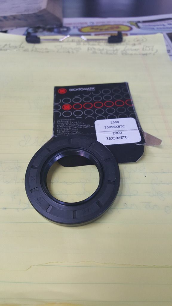

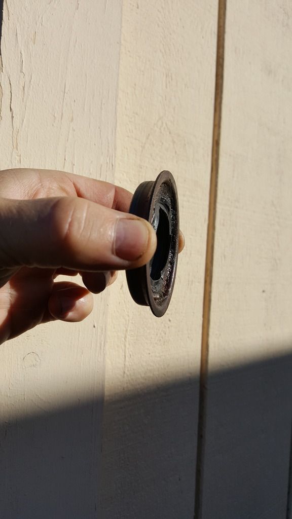

With the left-front 1/2 shaft out I decided to replace it's diff-output seal ($10). Unsure if the opposing right-side seal is identical (located at the end of the right-front's elongated axle-tube).
FRONT-LEFT DIFF OUTPUT SEAL DIMENSIONS: 58x35x11mm; 35mm is the approximate ID of the seal's rubber and may be spec'd larger by suppliers. The seal is a whopping 11mm wide because it has a flange that pancakes onto the outside of the diff:
(Incorrect, oversized seal sent TWICE by Amazon supplier even after online-chat with sales #@%&! )
I couldn't forfeit more time to source the OEM flanged seal, so settled for an adequate double-lipped substitute, Dichtomatik #2309. No flange, but excellent fit:

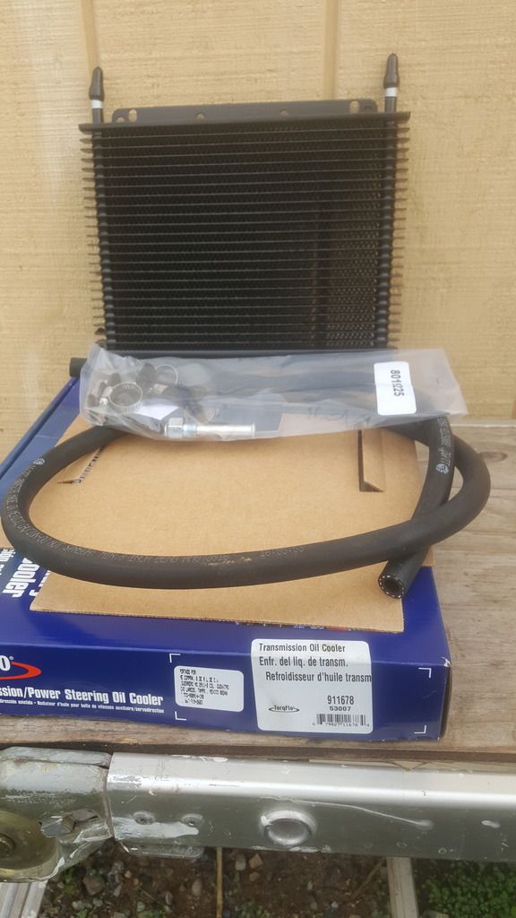

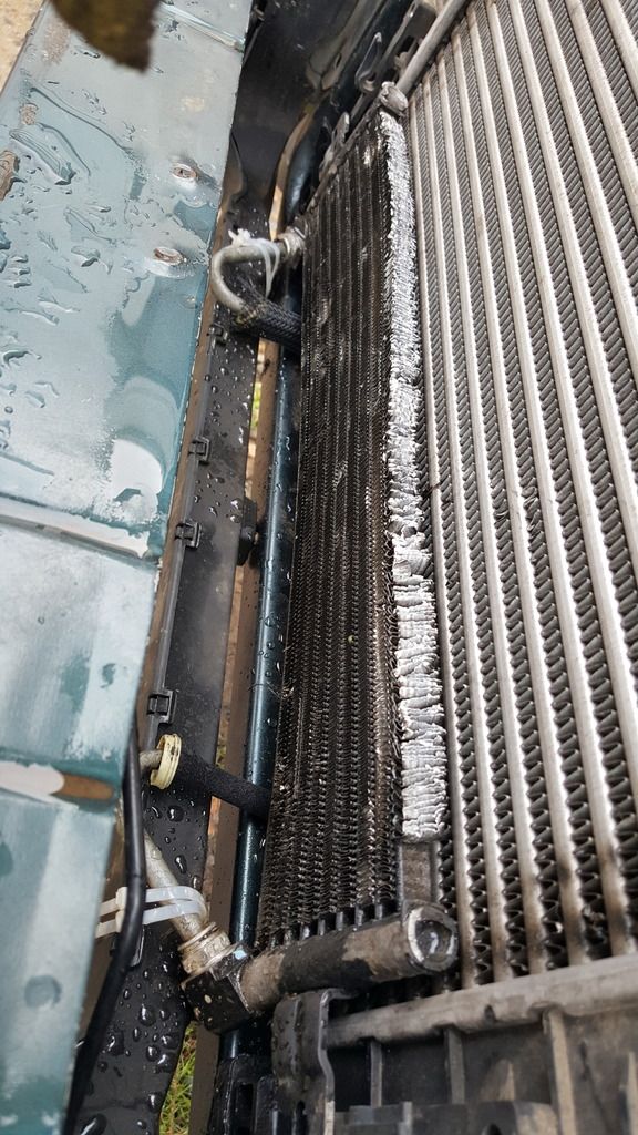

Question:

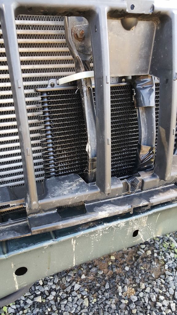

I replaced the cracked Trans cooler, allowing for the first "full-cycle" test-run to op-temp. Although it's been awhile since I listened to her croon, I think she's singing the right song. Stable idle, no stutter, smooth.
HOWEVER, after about a 1/2hour of idling (while I messed with the front-clip install), I hopped in and checked different throttle thresholds (stationary, in park). It behaved well in 500rpm increments BUT it's acting like it's "governed" and won't rev above 3400rpms at all. I am hoping in the extreme that it's just in "limp" mode while the ECU recalibrates. What's the deal???
A few more issues addressed.
Although the AC condensor portion was damaged, I was hoping to salvage the trans-cooler lower portion of the OEM combo unit (ala sawzall):
Wishful thinking. It was toast. Replaced with a $45 (azone, part #911678) universal Trans cooler:
In another post someone mentioned easing installation of an aftermarket cooler by removing the stock Trans hose-ends. However, they neglected to explain or illustrate how those OEM hose-ends are removed; they are retained by C-clips:
With the clips removed one end popped-off easily, the other side was sticky. Temporarily routing it under the frame cross-member for leverage, I used a crowbar to gently, yet effectively, pry-off the end without damaging the line:
Leaving nice extruded flanges for securing the rubber hoses to & from the replacement cooler:
Notable that I removed the CAC while doing this. When I saw how expensive those are to replace ($650), I elected to err on the side of "nowhere-near-the-crowbar", reinstalling it after.
I temporarily mounted the Trans cooler to the hood-latch post using mongo zip-ties. When I also install the replacement AC condensor I'll fab a more dutiful combo bracket:
At that time, I may also source a front-mounted electric dual-fan to mount on them.

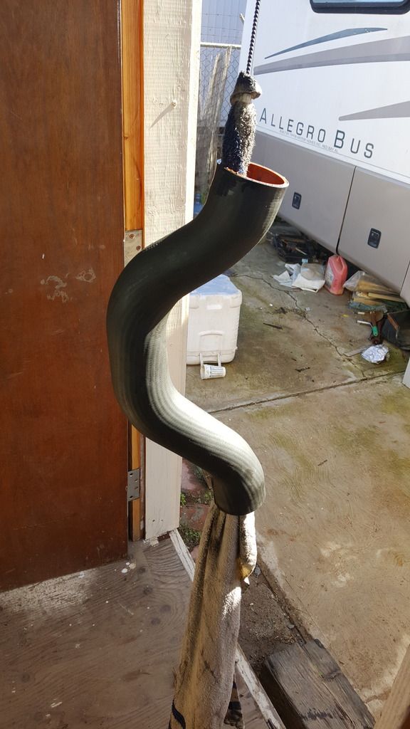

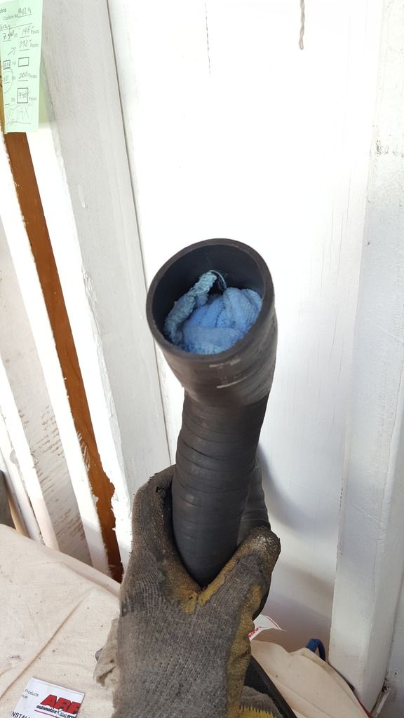

UPDATE:
I diagnosed my turbo issue:
DOH!!!
During R&R, to prevent critters squatting inside my hoses I had inserted lint-frees into them. Forgot this one in the CAC intake hose. Kinda' surprised it ran at all, but some air could get by...
Related, I badly wanted to de-grease the intake hoses that had been fouled pre-Sasq. and "EHM" (if my CCV-mod even qualifies). I soaked a towel with The Mighty DAWN and repeatedly snaked it through until they all shimmered:
I had intended to buy Samcos Pronto, but the CAC-Engine hose is clearly the later OEM silicone-lined and in very good shape. Hence, I'd prefer to replace only the turb-CAC hose. Is there anybody who sells these intake hoses separately?
Not that I saw.

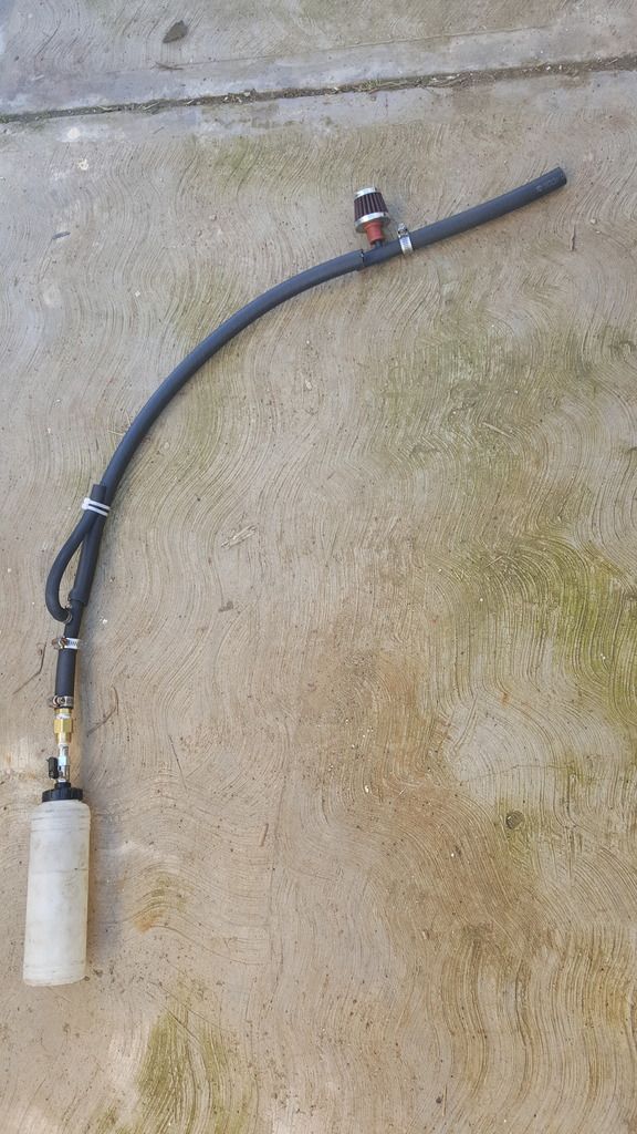

This is my DIY solution to the CCV issue; anybody see any intrinsic problems?:
Using parts already laying around, my thinking was this:
- Goofy mini-K&N filter is pointing up from the first T, located at the apex of the hose-run. This provides a close-proximity vent for air-pressure release, while using gravity to "encourage" oil-residue to continue down-tube
- Another T is located just before the screw-top catch cannister, providing a tap for another vent (looped-hose zipped to the main hose, pointing upward). The airflow volume of the two smaller-diameter (2x1/4"?) vents combined more closely match the stock vent-hose diameter (5/8"?). Also, the second-vent may serve as a venturi to help draw oil downward towards the...
- Screw-top catch canister for accumulating oil. A convenient vessel for emptying, as necessary. I'm still analyzing where exactly to route & secure the thing:
A. Route it to the outside of the turb, then down and ahead of the exhaust down-pipe, using mongo zips to kiss the tubing to the motor-mount while the canister sits atop the frame rail directly beneath, easily accessible for R&R.
B. Route it forward into the ARB front-bumper cavity. All kinds 'o room in there.
'15: bought '05 w/138k.

(Posted this stuff in "ARB compressor mounting location" thread, but may as well further bloat this saga, too.)
I also completed the ARB front/rear axle & pump/switches swap from my '05 gasser (sold) to my '05 CRD (I will be cold-and-dead but it will still be idling in the driveway, itching for adventure...).
I 'faked-in' the grill & headlights to establish installation clearance. Here's the pump mounting location I finally settled on. It's acceptable, but I wished I'd set it about 1/2" further back 'cuz there's only 1/2" of space behind the headlight. To ease access, remove the two bolts securing the PS cooling-line and move it out of the way during pump install:
Note how it was necessary to use the 'ole beijing vibro-tool to hum a small (ugly) notch in the bottom of the battery tray:
The mounting-location of the switches was chosen by the PO of the donor-Gasser. At first I thought it would be a knee-banger but in actuality not a problem. Imo, a plus is that the constant-on f/r "ready" lights are not another nighttime dash-distraction:
The trim-panel hinges downward, secured by two upper clips. I just swapped the trims between gasser and CRD; getting those plasti-formed hinges to snap-out was NOT easy (wonder-bar duty), but at least they aren't brittle plastic:
ZOOM-IN and you can observe which wire/circuit the ARB taps into; it's a big-boy, pink w/ yellow-stripe if I recall. Although there's a couple fatties in that loom, "The One" is the most accessible of them:
Naturally, the install wasn't dull. The front-diff's airline had an intermediate flange-bracket that was knocking against the serpentine. While removing that bracket I busted the OEM fitting -@%&$# !!!- Sourced a hose-barb with the correct fitting. Hopefully, double-clamped it will easily handle the air-pressure:
During the bout to repair the ARB line, I discovered that it was possible to leave the radiator connected (avoiding coolant R&R) and lift it forward enough to provide decent access to the area around the fan and the lower-left side of the engine:
Obviously, this is with the CAC safely removed.
